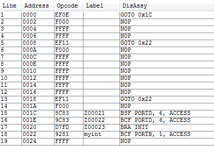

    Is there way to move RESET_ORG to other address, without moving interrupt vector?
    DEFINE RESET_ORG 004h also move vectors. In .LST file interrupt vector are defined as RESET_ORG+8h or 18h.
    DEFINE LOADER_USED 1 doesn't do anything. I'm looking in disassembled hex file...
    This is test code:
        DEFINE NO_CLRWDT 1
        DEFINE INTHAND myint    ' Define interrupt handler
        DEFINE INTLHAND myint    ' Define interrupt handler
    Start:
        PORTD.6=1
        PORTD.6=0
    GOTO Start
    @myint bcf PORTB,1
    Also I noticed that with or without NO_CLRWDT 1, there is no CLRWDT in hex file.
