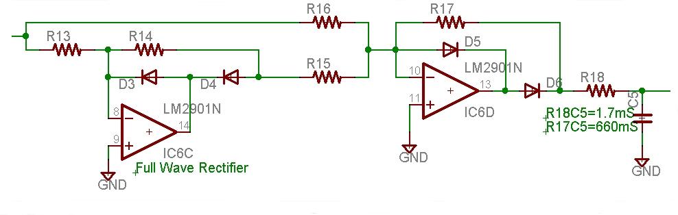

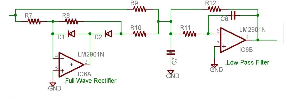

    With out a PIC the two attached pictures show an analog way of getting average and peak readings.
    The rectifier is:
    if MSB is 1 then shift left to remove that bit.
    if MSB is 0 then compliment number +1 then shift left.
    The peak detector (analog version):
    The meter moves up at a rate set by R18 & C5. (fast)
    The meter moves down at a rate set by R17+R18 & C5. (slow)

    There are several companies (THAT CORP and National see LM3915/16.) that have applications notes on the response of of VU meters. A typical test is to inject a 5khz tone for 10mS then stop. The meter should reach near full scale in 1.7mS and decay in 660mS.

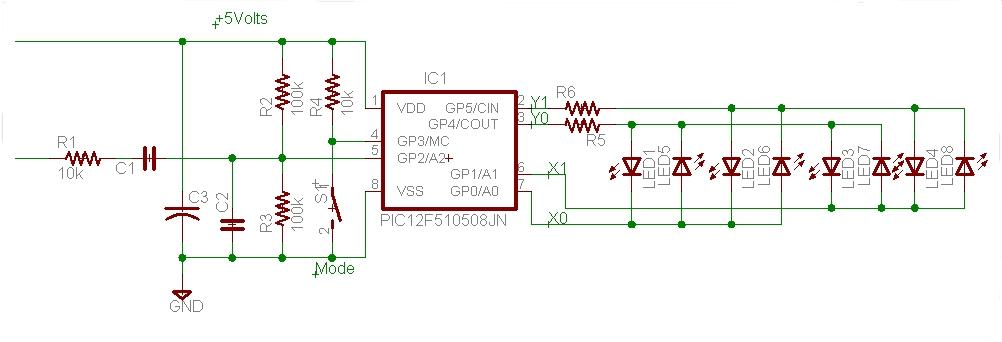

    My first try at a VU meter is attached. R2,3 set the input at 1/2 supply.
    C1 blocks DC. 1/(2*2.14*50k*C1)=20hz set lowest frequency of intrest.
    R1 & C2 makes a low pass filter to block information above 20khz.
    R1 is to limit the current going into the PIC if the signal gets above 5 volts or below 0 volts. Could be 1k.
    There is several better ways of setting the DC input of the ADC to 2.5 volts. More later.
