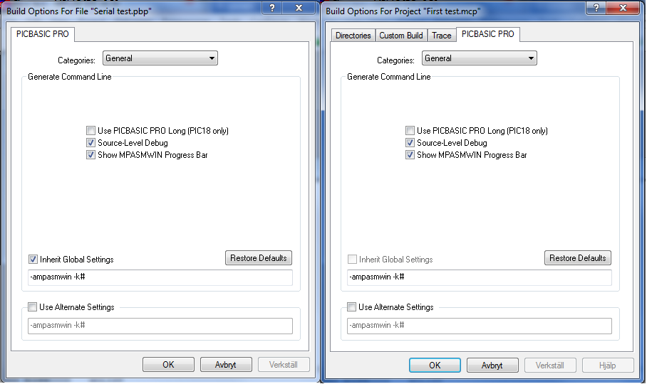

    However, I already had the Source-Level Dubug checkbox ticked and it keeps popping up the .lib file, see attached screenshots. Like I said in the other thread it's me who don't know how to use these tools but I'm trying to learn. I'll keep playing with it.

    What version of PBP are you using Henrick?
    Have you gone into Build Options for both the Project and the Source file?

    Hi Darrel,
    Yes, I believe I have done so for the project and the source file, see attached screenshot. Ticking/unticking it one place is reflected in the other as well so it looks like it's one and the same dialog accessed.
    There's only a single source file in the project (as per instructions) and there's no other files included from this source file.
