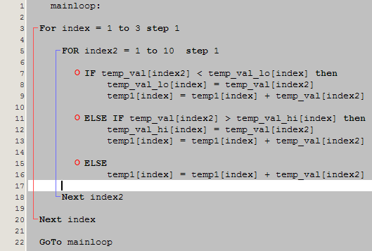

    440
    Default Re: Newbe: Nested For..Next loops problem
    Quote Originally Posted by Big Gaz View Post
    Sorted it!
    It was another issue lower down in the code, a missing ENDIF causing the compiler not to find the the two NEXT statements.
    Exactly what FinelineIDE is for.
    Red "O" is for orphan.
    Norm
