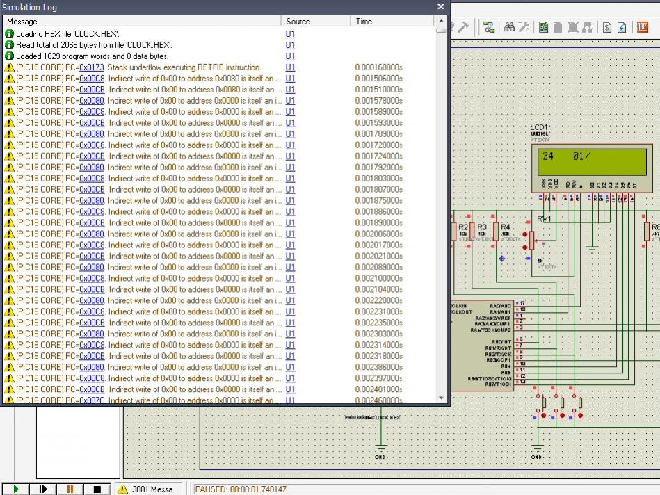

    Hi everyone !
    I try to build for my use , in home, one clock with dual termometer, using 16F628A, 2x16 LCD and 2 x DS18B20. I wrote the code, but... at every minute I have a few seconds more...I don't have a clue where it's the mistake. Can help me, please ? Thanks in advance !

    That is one of the problems with ON INTERRUPT. It does not interrupt until the main code gets a break. If, for example the code is in a PAUSE when the interrupt happens, the code will not go to the ISR until the PAUSE is complete.
    You will need to use ASM interrupts or DT's instant interrupts.
    Hi, Fratello
    Even using ON INTERRUPT ... you shouldn't have such a time error ... ( just display " not so regularly " the correct HH:MM:SS )
    but maybe you could write the shortest as possible interrupt stubb, not jumping from here to there ...
    the problem looks to be your interrupt stubb is longer than the time between two Timer interrupts. ( 1/61 s ? - from your ISR calculations )
    Dec 2008
    Ploiesti, ROMANIA
    582

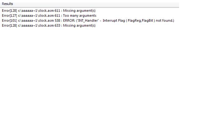

    Ok, I think that my previous code it's wrong in his essence...so...
    I try another two version, based on codes from : Paul R. Borgmeier, PhD (see EZCLOCK1) and Mr.Bruce (see RENTRON.COM). Still not good precision ... Any ideeas ?
    @ DEVICE pic16F628A, XT_osc, WDT_OFF, PWRT_OFF, BOD_OFF, MCLR_ON, LVP_OFF, CPD_OFF, PROTECT_OFF     ' for PBP 2.4

    I re-re-re-read all the topics on this forum (searching for "timer") and I found one code (Josepino's code) for HIGH-accuracy clock.
    I try to compile them, but I have errors. What I do wrong ?

    I have not tested it, but me thinks:
            INT_Handler   TMR0_INT,   int_handler,   ASM,  yes
    is a NO NO.
    Try using a unique name to name your handler.
    Dec 2008
    Ploiesti, ROMANIA
    582
    Thanks for support ! I changed the name, but...
    It compiles here. I renamed the interrupt handler to ISR (changed the label) and adjusted the DT-Ints declaration accordingly:
            INT_Handler   TMR0_INT,   ISR,   ASM,  yes
        INT_ENABLE  TMR0_INT     ; Enable Timer 0 Interrupts
    And
    ;  INTERRUPT HANDLER     (runs this code each timer0 interrupt)
    ISR
    I compiled it for a 16F628A for which I had to add
    INCLUDE DT_Ints-14.bas
    wsave VAR BYTE $70 SYSTEM
    wsave1 VAR BYTE $A0 SYSTEM
    wsave2 var BYTE $120 SYSTEM
    Make sure your compiling "from" the main source file and not from within the timp.pbp.txt file.

    Thanks for support ! Yes, in this way I compiled the code. Unfortunately the result are so strange ...the display show random numbers - quickly changed, the errors messages are without end
