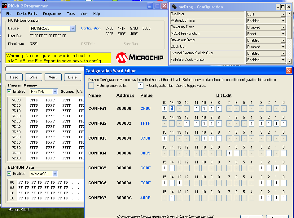

    You can see which configs are set in the Hex by loading the hex file into your programmer. Then look at the config settings and see what they are.
    On a Melabs programmer and a Pickit2 programmer:

    Within EPIC software menus, you should be able to see and modify the configuration fuses.
    If you want to edit them, well do it within EPIC software then save changes (make sure you made abackup of the file BEFORE)
