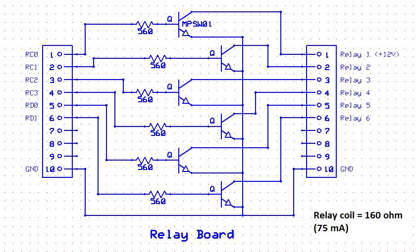

    Thanks Guys -
    I am scouring through the hardware. Attached is the schematic ...

    Default 1 bad $.50 transistor
    Can really mess up a few days...
    Thanks to all for the support. I guess the fact that when written with binary logic the program worked fine - it threw me for a loop and took focus off the hardware. My apologies ...
