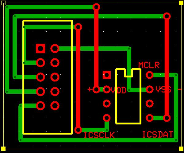

    I can not seem to program a 10f202 I always get "programming error at 0000" however if I read it I can write the info back to the chip?
    Quote Originally Posted by n0yox View Post
    Code?
    What are you reading from the chip ?
    Sound high likely an ICSP problem. Which programmer & Software?
    Did you tried on a Ziff socket? Are your sure your ICSP circuit is properly implemented?
    Mar 2008
    59
    Cool 10f202
    I am using an epic plus programmer ver.4.22 and picbasicpro ver 2.50. I have a homemade programming adapter. I can read the blank chip "all 0fff" and the calibration register. I can load the hex file that I just read but can not load the hex files I create. I have no problem with other micros, however this is the only micro I just this program adapter with?
    Thank you for your help!
    Mar 2008
    59
    Default program adapter
    I believe this is correct for the epic programmer?
    What about the code you are trying to load?
