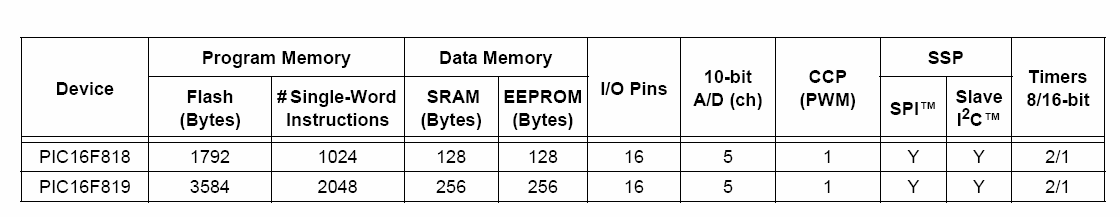

    What PBP calls HPWM, Microchip calls it PWM. The cheat sheet is page 3 of the PDF, or page 1, if you look at the page numbers.
    It shows the 819 has one PWM (or HPWM). Yes, this command is persistent. More about it in chapter 9.
