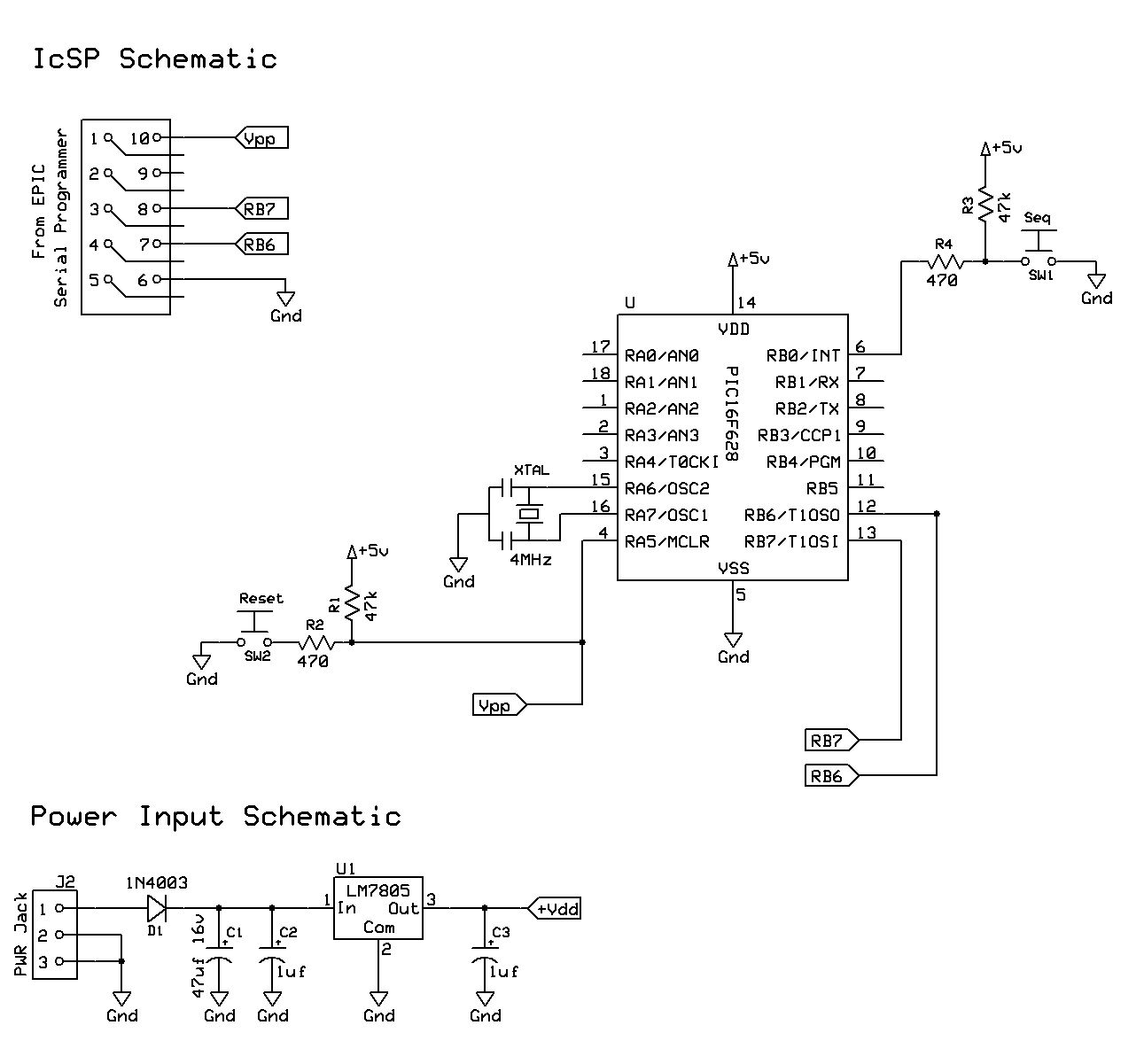

    I have a working circuit where i would like to use In-Circuit Serial Programming. I am using MeLABS EPIC Serial Programmer.
    Unfortuanatly, i am not getting very far. I have attached a circuit diagram of the ICSP part (main circuitry not shown).
    The PIC is a 16F628A.
    Has anyone successfully used this combination, if so, what am i doing wrong. Its basically saying the PIC is not detected.

    I am using the EPIC parallel programmer with ICSP and I used the drawing from the MELABS site that shows 5vdc connected to pin1 of the ICSP connector. I am using this setup on 16F74's. The only thing I have noticed that is different on my ICSP setup is one of the led's on the EPIC board stays on even when I am not programming. I do have my board removed from the normal power source of my product so it only gets its power through the ICSP connector. Try it and see if it makes a difference.

    I have a blocking diode between the MCLR pull up 1K resistor to prevent the programming voltage from damaging my circuit. I have another board that has ICSP on it and there I have a VFDisplay data lines on RB6 and RB7 so I put a DPDT toggle switch between the display and the ICSP connector so I don't cause any problems with the display while programming. It works okay also.
    I did notice on your schematic that it shows a 16F628 and your posts mention a 16F628A. I'm assuming that this was the only label of the chip diagram being different.
    Perhaps this could be of help: (From MELabs help support)
    Note for PIC16F62x: RB4 should be connected to ground to prevent interference from the Low Voltage Programming pin.
    If you can program through the ZIF but not the ICSP connection them maybe there is something wrong between the ICSP and the PIC.
    At this point I'm out of ideas. I know I've had my share of head scratchers lately too!
    BobK.

    I thought i was going mad, but a short break solved the problem !!
    It was operator error. I messed up the numbering system on the IDC header.
    I had the numbering system as
    1 6
    2 7
    3 8
    4 9
    5 10
    When it actually is:
    1 2
    3 4
    5 6
    7 8
    9 10
    It now works perfectly !!
    Cheers for your help.
    Steve.
    Mentor, Ohio
    352
    Thumbs up
    Hi Steve,
    So the drawing you posted was wrong? You showed:
    1 10
    2 9
    3 8
    4 7
    5 6
    This is also how mine are wired which matches MELabs.
    I'm glad you did get it to work though!
    It was a great exercise for me.
    Have a nice day!
    BobK.
