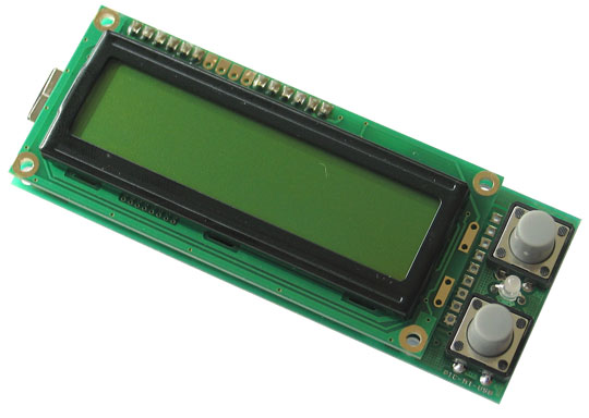

    http://www.sparkfun.com/products/27 $36.95
    • ICSP/ICD connector for programming with PIC-MCP-USB, PIC-MCP or PIC-PG1, PIC-PG2, PIC-PG3, PIC-PG4 and debugging with PIC-ICD2, PIC-ICD2-POCKET, PIC-ICD2-TINY or is PIC16F87X microcontroller is used PIC-ICD1
    • DIL-40 for PIC microcontroller
    • LCD 16x2 alphanumeric display with backlight
    • 2 Buttons
    • bi-color LED
    • Power supply taken from USB port
    • Virtual USB-RS232 port
    • 20 Mhz crystal
    • FR-4, 1.5 mm (0,062"), green soldermask, white silkscreen component print
    • Dimensions 95x36 mm (3,7x1,4")
    • Four mounting holes
    • Extension headers for PIC unused ports

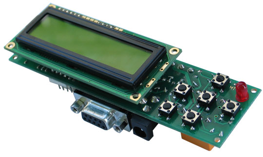

    http://www.sparkfun.com/products/26 $38.95
    • ICSP/ICD connector for programming with PIC-MCP-USB, PIC-MCP or PIC-PG1, PIC-PG2, PIC-PG3, PIC-PG4 and debugging with PIC-ICD2, PIC-ICD2-POCKET, PIC-ICD2-TINY(* for the PICs with ICD support) for PIC16F87X there is low cost PIC-ICD1
    • Dallas touch button port
    • Frequency input
    • 0-10V and 0-5V ADC input with buffer OAMP
    • RS232 DB9 female connector
    • RS232 interface circuit with Tx, Rx signals
    • RS232 TTL levels output connector
    • Voltage regulator +5V, 78L05 and filtering capacitors
    • Quartz crystall oscilator circuit 20Mhz
    • DIL28 microcontroller socket
    • Relay with 10A/250VAC contacts
    • Buzzer
    • Status LED on RB4
    • Power plug-in jack
    • Dimensions 120x36 mm (4,7x1,4")

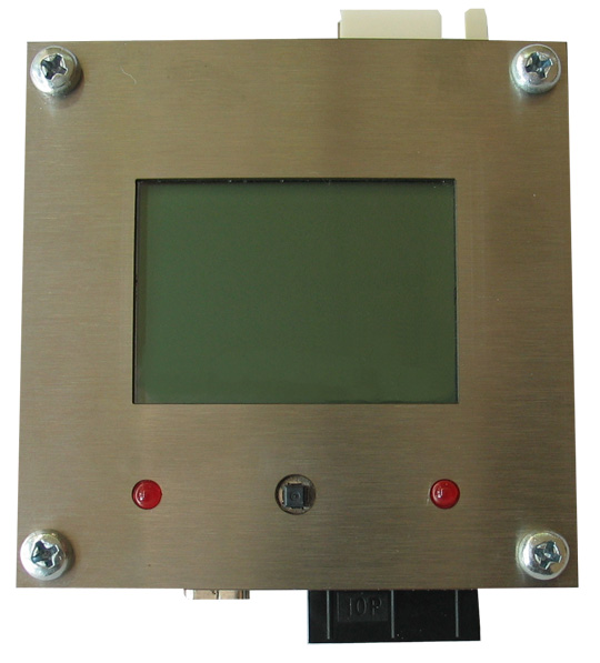

    http://www.sparkfun.com/products/8855 $50.95 (probably shouldn't be in here, as you can't change the pic chip, but I like it.)
    • MCU: PIC18F67J50 with 128KB Flash memory, 3904B SRAM, 10-bit 8-channel ADC module, PWM, SPI, I2C, EUSART, 2 Analog comparators and 8/16-bit Timer/Counters
    • ICSP connector for PIC-ICD2/PIC-ICD2-POCKET debugger/programmer
    • LCD NOKIA 3310 black/white 84x48 pixels
    • Two status LEDs
    • Joystick with LEFT, RIGHT, UP, DOWN and CENTER action
    • mini USB connector
    • SD/MMC card connector
    • MMA7260 accelerometer
    • Extension connectors for all PIC ports
    • +(4.5–6.0) battery connector
    • PCB: FR-4, 1.5 mm (0,062''), soldermask, silkscreen component print
    • Dimensions 65x65 mm (2.56 x 2.56")

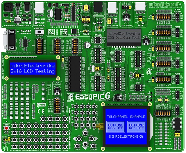

    http://www.mikroe.com/eng/products/v...opment-system/ $139.00 without blue LCD displays -- More info: http://www.mikroe.com/eng/downloads/...ticle_v100.pdf
    Sure it's huge, but it does 10F, 8,14,18,28 and 40 pin chips (as long as they are 5 volt varieties)

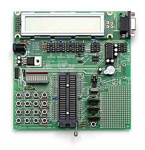

    http://store.melabs.com/prod/boards/LABX1A.html
    $199.95
    • Inputs: 16 switch keypad, 3 potentiometers, IR, temperature, real time clock
    • Outputs: LED bargraph, 2x20 LCD module, speaker, DTMF, PWM, IR, 2 RC servo connectors
    • I/O: RS232 interface, RS485 interface
    • Serial EEPROM: I2C, SPI, Microwire
    • Misc: Reset button, 5-volt regulator, 40-pin ZIF socket for PICmicro MCU (device optional)
    • Jumper selectable oscillator from 4MHz to 20MHz
    • In-circuit programming/debug connectors
    • Prototyping area for additional circuits
    • Available assembled, as a kit or as a bare PCB
    • Size is 5.5" x 5.6"
