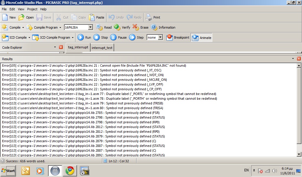

    i've been trying to use the interrupt commands but i get a lot of errors. I used both files
    INCLUDE "DT_INTS-14.bas" ' Base Interrupt System
    INCLUDE "ReEnterPBP.bas" ' Include if using PBP interrupts
    First error i get is that micro assembler does not support 16F628a, and it is asking to use the MPASM for compiling.
    then if i use the MPASM i get again a lot of error like the attached pic.
    i dont understand why it says that cannot filnd the pic16f628a.

  6. #46
    Default Re: Displaying Videos and Images on 4Dsystems uOLED Serially
    You must use MPASM with DT's interrupts.
    Then you will need to use MPASM type configs

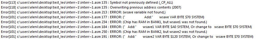

    i used the following config
    @ __config _INTRC_OSC_NOCLKOUT & _WDT_ON & _PWRTE_ON & _MCLRE_OFF & _BODEN_ON & _LVP_OFF & _CP_ALL & _DATA_CP_ON
    @device pic16F628a
    and now i get the following errors
  9. #49
    Remove
    device pic16F628,
  10. #50
    Seems you edited while I was posting.
    now your answer is in the error message.
    read through till you come the the ADD part

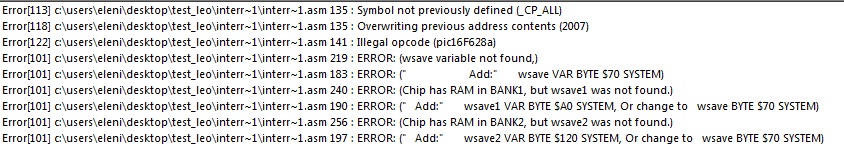

    now i get the following errors.
    I dont want to disturb you more.
    I'm really sad to not understand what are these errors and why it does not work.
    regards

  12. #52
    No problem.
    Try changing the config line to
    @ __config _INTRC_OSC_NOCLKOUT & _WDT_ON & _PWRTE_ON & _MCLRE_OFF & _LVP_OFF & _CP_OFF
    and make sure the *.inc file is commented.
    Then add
    wsave VAR BYTE $70 SYSTEM
    in your VAR section
  13. #53
