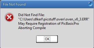

    I am trying out FL IDE and get the same thing as in this FL1_6_0_0.pdf. The Code compiles fine inn the MCSEX IDE.
    Locate the error file and check the error message file path exactly against the actual file path for any differances.
    Post the file path.
    Norm

    From what I can tell the paths are correct. The Path is C:\Users\Charlie\ Documents\PBP Projects. The project compiles fine using MCS.

    Did you find the .ERR file?
    Open Windows explorer and browse to the "C:\Users\Charlie\ Documents\PBP Projects" directory.
    If not intentionally generate an error to see if it is found.

    It's there but its called test.er instead of test.err

    I will start on an update to look for .er if .err isn't found.
    PM me your email address for a test copy.

    I'm seeing this behavior with 2.0.0.0:
    Source path is C:\Users\dlkerl\picstuff\oven
    The path is identical in the error message, but the file name in the source directory only has one 'R': OVEN_V0_3.ER (empty file)
    MCS launches PBP with no problems (PBP 2.45)
    Unrelated question: Is it possible to stop automatic indentation of labels in ASM blocks?

    The .ER file is the PBP compiler text to assy error file.
    The .ERR file is the MPSAM assy to hex error file.
    Possibly the "Users" in C:\Users\dlkerl\picstuff\oven is throwing FL off?
    Try compiling with your program file in a non Users directory.
    Yes I should be able to disable all auto indent of assy lines if that would be best?
    Anyone familiar with assy please advise.
    I am presently finishing up the pre beta of FL 2.1.0.0 with several fixes.
    Norm
