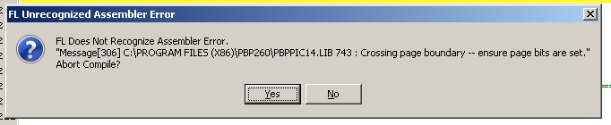

    Hi Normnet,
    I was wondering if I can, like MCS does, avoid the Crossing page boundary error?
    Name:  2018-01-06-FineLineIDE   D__PBP_Timer_16F690_01-01-18A.bas   PicBasicPro.jpg
    I'm using your version 3.3
    Roger

    ...I forgot to mention that I currently use this method as a turnaround to avoid the error message:
    @ ERRORLEVEL -306 ; turn off crossing page boundary message
    Roger

    Hi Normnet,
    [I'm using your version 3.3
    Not at present...sorry.
    Norm
