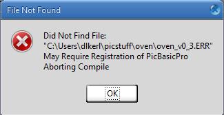

    Norm, I encountered a problem with FL not being able to compile the ReEnterPBP-18.bas version 1.4 which was an INCLUDE in one of my application codes.
    Has anyone else had this problem with ReEnterPBP-18.bas ??
    John Ellis
    It looks like the compiler is indicating an error which is PBP not FL IDE.
    Is the result the same with MicrocodeStudio IDE?
    Norm
  2. #42
    4,184
    Default Re: FineLineIDE
    Are you compiling the ReEnter.bas routine itself?
  3. #43
    It looks like you haven't selected a device yet.
    Select an 18F and try again.

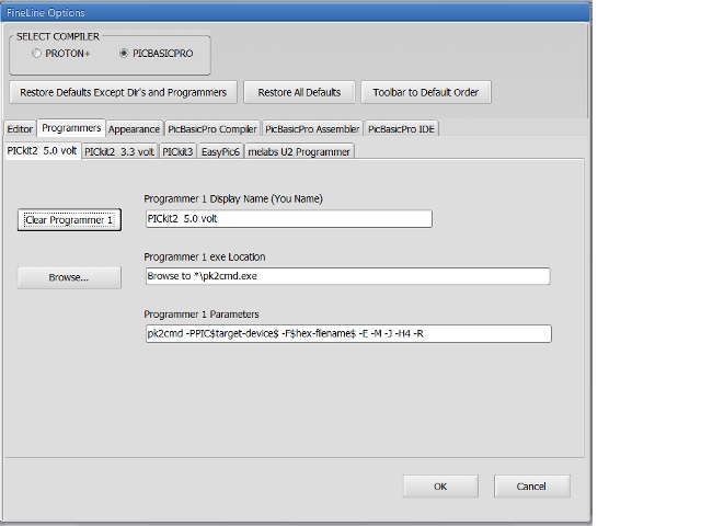

    Is it possible to add compatability with Asix UP Presto programmer http://tools.asix.net/prg_presto.htm
    Tim.
  5. #45
    440
    Quote Originally Posted by timmers View Post
    Tim.
    From "Using UP from the command line" under "Tips and tricks" in the help section of the UP software program.
    The program itself ensures to be run in a single instance. If there is another instance being run, the command line parameters are handed over to the already running instance to be executed.
    Parameter overview
    up.exe [{/ask | /q}] [{/e eeprom_file.hex | [/noe]}] [{/p | [/pdiff] | [/o]} file.hex | file.ppr] [/eeonly] [/part part_name] [/erase] [/w[nd] up_window_class] [/cfg ] [/devid ] [/blank ] [/verify file] [/s programmer_SN]
    Legend:
    The text in bold is to be put on the command line as is.
    The text in italic is to be replaced by real parameter, e.g. file_name is to be replaced by real name of the file to be opened.
    Text in curly brackets separated by | (pipes) represents a single choice from the listed items. e.g. { A | B } means "choose just one of A or B".
    Text in [braces] represents optional parameter which can be used, but can also be omitted.
    /ask Ask. To be used with /p. If the parameter is used, the program always prompts the user whether to program the part, even if this was disabled in the Settings of the program. The confirmation dialog also shows selected part type.
    /q /quiet Quiet mode. In this mode the program does not require any user intervention, but rather silently returns to an error code instead of displaying a dialog. See return error codes.
    /e file EEPROM file. Name of a file containing EEPROM data. If the name contains spaces, it is necessary to enclose it by quotes. This parameter can be used together with /o or /p parameter only.
    /noe No EEPROM. Causes the program to skip EEPROM programming. If used with the MSP430 devices, the program skip all operations with the information memory.
    /p file Program. Programs given file to code memory. If the name contains spaces, it is necessary to enclose it by quotes.
    /pdiff file Program differentially. Programs given file. If the name contains spaces, it is necessary to enclose it by quotes.
    /o file Open. File with given name will be opened. Optional parameter. If the name contains spaces, it is necessary to enclose it by quotes.
    /eeonly The programmer will do the selected operation for EEPROM memory only, with MSP430 for Information memory only.
    /part name Selects the specified part in the UP.
    /erase The part will be erased.
    /wnd class name Select another window class name. Using this parameter you can open more than one instance of program UP. Each instance must have unique window class name.
    /cfg If this parameter is used together with /p parameter, only configuration memory is programmed. It's useful for example for AVR devices programming, because the user can configure the chip for faster oscillator first and then to program it much faster.
    /devid If this parameter is used together with /p parameter, only the Device ID of the chip is checked.
    /blank The program will do Blank Check of the chip.
    /verify file Does the part verification.
    /s programmer_SN This parameter allows to select the programmer in accordance with its serial number. The serial number can be entered as it is displayed in the UP or printed on the programmer, e.g.016709 or A6016709.

    Hi Norm,
    Thanks for that, I hadn't spotted the setups were configurable. However, I cannot get FL to use any programmer except the first one in the list. So I changed the first one to the Presto.
    If UP is allready open with the correct device allready selected, the filename is picked up and performs an erase, programme and verification fine. (command line switches field empty). If I add /part $target-device$ it doesn't change to the selected device as if its ignoring the switch. The filename is picked up without any switch options!
    If UP is not open, a popup window opens and asks for the device type. If I enter the device, UP will only blank check without erasing or programming the part. All switch options are ignored.
    Is there an option to not convert tabs to spaces? I like working with tabs and would like to continue so.
    STOP PRESS.
    Having closed FL and re-opening, I now get the error message "no previous picbasic pro programming" and closes the session when attempting programming.
    Any suggestions?
    (WIN XP pro)
    Tim.
  11. #51
    440
    Hi Norm,
    STOP PRESS.
    Any suggestions?
    (WIN XP pro)
    Tim.
    Just a guess but try /part target-device
    Keep trying variations.
    Tabs don't work well with FL as each tab width is different depending on the line above indentation.
    This makes it much slower to determine the start point for drawing the FineLine if-endif brackets.
    The tab key will still work in FL however it will write/save in spaces rather than a variable width tab.
    I'll try a line by line tab width measurement for the next version as an option however to see if it is feasible.
    "no previous picbasicpro programming" is a message displayed when pressing the Program Only button before having first compiled.
    Try compile and program first.
    Norm
Size:  55.8 KBNorm, I am having a problem using FL v1.0.0.4 with PicKit2 programmer. It works fine with EasyPic6/PicFlash programmer, but I had to reprogram a device in the field using my laptop with PicKit2. I am using PicKit2 v2 and PBP 2.6 with MPASM assembler. I am somewhat confused by the FL Programmer Options as shown in the attached image where it shows an option for "PicKit2 5.0 volt" and an option for "PicKit2 3.3 volt", as if there are two different PicKit2 products...one for each programming voltage. Yet the PicKit2 I have leaves the selection of the programming voltage to a selectable tool in the PicKit2 screen, so I don't know which option to use with my PicKit2 v2. Can you please clarify what these two FL options for PicKit2 are really saying and which one to use with PicKit2 version 2?
    I also notice that the browser default for the" PicKit2 5.0 volt" option points to a file at "Browse to *\pk2cmd.exe". Yet I find no file by that name in my PicKit2 installation. The .exe file normally used in my installation for PicKit2 from Microchip is "PICkit2V2.exe". I tried to use the browser to select this one in the FL option and it didn't work with FL. What are the .exe file names that should be used for either the PicKit2 5.0 volt option or the PicKit2 3.3 volt option in FL??

    Quote Originally Posted by jellis00 View Post
    Goto PICkit™ 2 Development Programmer/Debugger and down load the command line version PK2CMD v1.2
    The *\ signifies a wildcard before the pk2cmd.exe
    An "-A3.3" without the quotes in the command line signifies 3.3 volts other wise will default to 5.
    Your PICkit2 tabs should look like the following:

    Thanks, Norm. That solved my problem of getting the PicKit2 to work with FL.
    However, I notice a new anomaly I don't know how to interpret. After each use of FL to program via the PicKit2, a message appears in PicKit2 in yellow after the programming is complete saying that I have to dowload a new OS for PicKit2. However, if I close PicKit2 and start over with another programming action it works fine with the OS I have. This never has happened before in my use of my OS version of PicKit2.
    Is there something in the cmd file that checks your version of PicKit2 OS and tells you to update? Do I really need to? The version I am satisfied using and I hesitate to upgrade because evertime I have ever upgraded to anything from Microchip I spend the next week trying to resolve all the incompatibilities.

    I just installed my PBP3 upgrade today, and hence also needed to download/insstall FLIDE v1.6.0.0 to have PBP3 compatibility. I copied over the FineLineIDE.ini, CoolbarPositions and Skins from my previous v1.5.0.0. I then checked all the options to make sure they copied over, which it appeared they did. However, I am now having problems.
    1) When I attempt to compile a program that always compiled/assembled OK before, I now get the error as shown in the attached screen snapshot file, FLI1_6_0_0.pdf.
    I checked for the file name that is mentioned with an .ERR extension and it is located in the same folder as where the .pbp file is that I attempted to compile. So I don't understand why it is saying it can't find the file and is giving me this error that prevents compile/assembly.
    Can you please advise me how to solve this problem?
    Regards, John Ellis
    FL1_6_0_0.pdf
  31. #71
    What does the *.ERR file say when you open it in notepad?
    Norm,
    Regards, John Ellis
    Attachment 6380
    Do a check to be sure the path in the "Did not find file" message is exactly the same as the file path in the same folder as where the .pbp file is.
    Paste the path on the forum including the file name.
    Possibly even upper/lower case could produce an error.
    Norm

    Upon more digging and testing, it appears this problem may have been caused by the fact that my PBP3 install was not "activated" yet. I hopefully will get activation key Monday and will see if this solves the problem. Till then?

  39. #79
    Mar 2009
    Colorado
    378
    Did activation solve the problem?
    If so I will "You may require activation of PicBasicPro" to the error message.
    Norm
    Before I activated I did some other things. Now that it is activated it works, but not sure whether that was the single act that let things work.

    Hello Everyone,
    I am trying out FL IDE and get the same thing as in this FL1_6_0_0.pdf. The Code compiles fine inn the MCSEX IDE.
    CharlieM
    Using PBP3
    MCSPX
