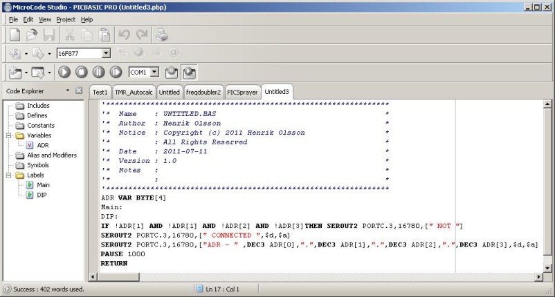

    Norm, I cut/pasted some of Mackrackit's code for a ConnectOne WiFi module into FineLine and see something I can't figure out as shown in this code snippet:
    DIP:
    IF !ADR[1] AND !ADR[1] AND !ADR[2] AND !ADR[3]THEN SEROUT2 PORTC.3,16780,[" NOT "]
    SEROUT2 PORTC.3,16780,[" CONNECTED ",$d,$a]
    SEROUT2 PORTC.3,16780,["ADR - " ,DEC3 ADR[0],".",DEC3 ADR[1],".",DEC3 ADR[2],".",DEC3 ADR[3],$d,$a] PAUSE 1000
    The actual code listing in FineLine shows a red "0" at the beginning of the IF statement line. I tried to delete it and it won't delete. What is this red "0" signifying or trying to tell me?

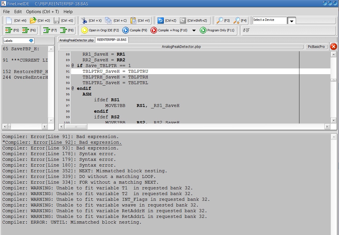

    Yes the "if-IF" button is "Format All".
    The reason for separating the Explorer types is a lot less scrolling.
    When "showing all" most are hidden.
    The next version of FL however replaces the Explorer drop down box with a one click "radio button" for a fast change of display type as displayed below.
    On my PC a hover over the "if-If" button displays a yellow "Format keywords for PicBasicPro".
    Norm
    The red "O" is for orphan.
    FineLine is telling you a corresponding Endif is missing.
    See screenshot in previous post.
    Norm
    Default Re: FineLineIDE
    Norm,
    In your screenshot the ENDIF is missing but in the code snippet Jellis posted it's not missing since the IF statement is a "one-liner"
    440
    Norm,
    PBP V2.50C gives the following error:
    Compiler: Error[Line XXX]: If without a matching ENDIF.
    Norm
    Hi Norm,
    Really? That's a surprise....It compiles without error here (on v2.44):
    Weird... I'll try it on 2.6 tonight.
    I did that before FL. It does work with PBP 2.6.
    I just tried it with FL and got the "O", but it compiled..
    440
    I'll fix it for the next version of FL.
    A workaround is to keep a space in front of the "Then".
    Norm
    The space fixed it!

    Norm, I encountered a problem with FL not being able to compile the ReEnterPBP-18.bas version 1.4 which was an INCLUDE in one of my application codes.
    Here is the code for version 1.4

    And here are the errors:
    Has anyone else had this problem with ReEnterPBP-18.bas ??
    John Ellis
