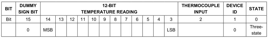

    Did you look at the data output pin on the MAX chip with your O-scope to see if it's changing the value sent?
    If you send 16 clocks, and the data line stays at ground, I would think there's a problem with the MAX IC. If you see transitions on the data line, there's something going on with the PIC side.
