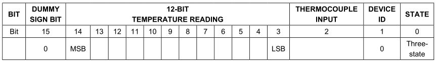

    TempC = MXtemp >> 5   'right shift the data 5 places to get degrees C (Read the Data sheet)

    i found in this post (http://www.picbasic.co.uk/forum/show...1178#post71178) that you stated you need a temperature
    reference for every time the wire material from the thermocouple changes.
    Anyplace the wire material changes you need a reference temperature and calcs. A couple exceptions here and there though.
    I had copper wire soldered to the terminals on my thermocouple. I disconnected the copper wires but it didn't help

    According to the MAX6675 datasheet: "Read the 16 output bits on the falling edge of the clock. The first bit, D15, is a dummy sign bit and is always zero. Bits D14–D3 contain the converted temperature in the order of MSB to LSB".
    If I get it well, when reading the termocouple, I get 16 bits and I need to "keep" bits 14 to 3.
    Name:  2017-04-15 21_53_35-MAX6675K-Type Thermocouple IC.pdf - SumatraPDF.jpg
    So, to get the (what I hope is correct) right value, why do I have to shift by "2" instead of what has been said above (shift by 3) or even shift by 1 since bit 14 is the second bit to start with?
    Roger
    the data can be read in msb first by shiftin but it is then translated to a normal binary representation so bit 14 is read as bit 14.
    shifting by 2 is incorrect , as dave indicated
    Temp = RawTemp >> 5
    will get the high 10 bits of the 12bit reading ,resulting in the integer component of the reading
    or
    Temp = RawTemp >> 3
    int_part=temp/4
    fract_part=(temp//4)*25
    lcdout $FE, $C0,"Tmp ", #int_part,".",dec2 fract_part," C"
