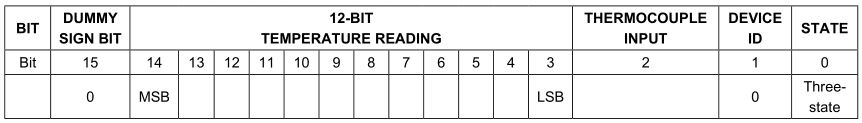

    Thanks Richard,
    With your calculation example you gave me above, I could understand how to read my result.
