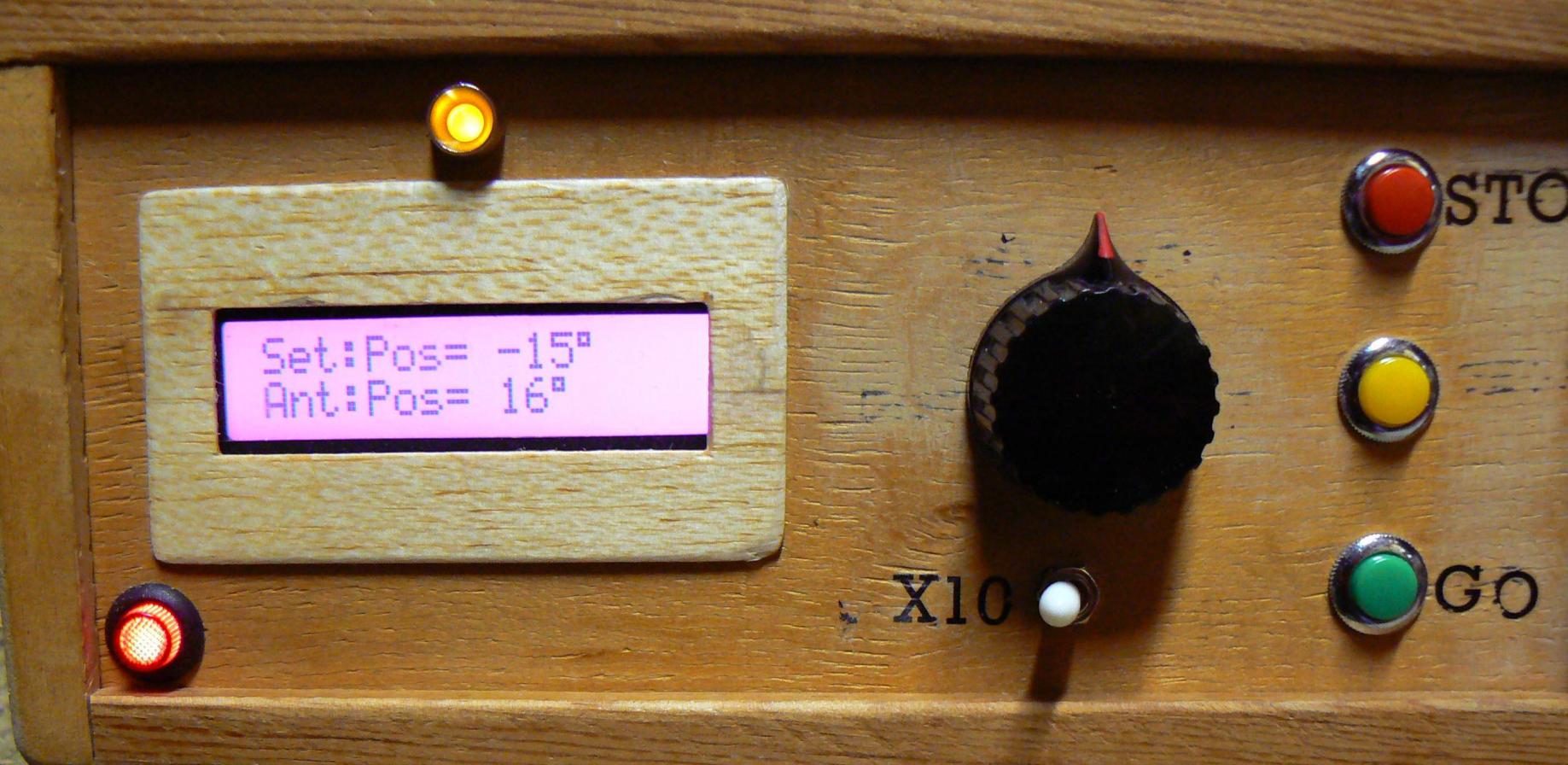

    Default Re: Display Degrees of rotation.
    I may have to consider that.
    I only have a hand drawn schematic.
    Here is a picture of the almost completed project. I still need to finish the labeling.
