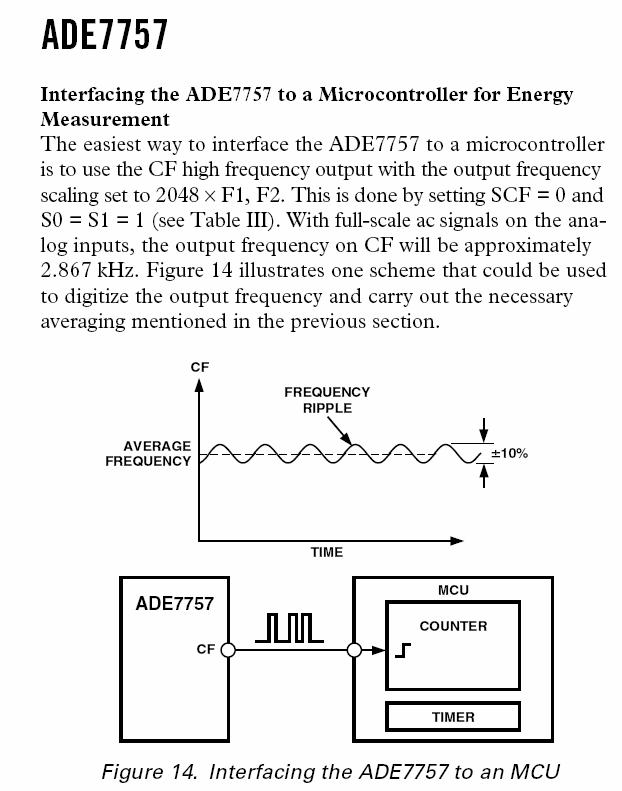

how to conect ade7757 interface pic 16f877

    how to conect ade7757 watt meter interface pic 16f877 with pbp
    And show schematic to conect
    thank you for all answer
    I deleted your other post. There is no need to double post the same question.
    Here is an example from the data sheet on page 11.
    Maybe more looking on google will find something more, but the interface part looks pretty easy. Code is probably the harder part.
