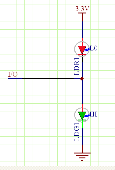

    Hi All,
    I have one red LED and one GREEN led and a few resistors and only ONE pin left on my MCU. It would be nice if there is a way to turn on green or red or have them both off.
    Since the pin has 3 states it might be possible but today my brain just can't see how. Current goes in .. one LED is on... Current goes out.. the other one is on. But it is possible to have them both turned off without haveing any leaking current when the pin is in tri-state?
    I never plan to have them on at the same time... just both off or one or the other on.
    thanks!

    Can't you?
    My turn to say DOH!!!
    No matter how you connect two LEDs without extra hardware there will be feed back between the two.
    A couple transistors or sayzer's solution are in order for this one.
    How many DOHs are allowed in one day???

    Mar 2006
    China
    266
    Default well
    Then we have the problem with the idle current.... 2 resistors in serie between Vdd and Vss is going to drain the battery. I like the idea! but the idle current will be almost half of what the LED uses when it is turned on (sssuming 5V Vdd and 2V voltagedrop over the led)
    I dont have my lab stuff here.. does anyone think the idle current might be lower in the circuit i have attached.. or will smoke come out :-)
    Sure there are many ways to solve the problem by adding more things but I am still hoping this will work...
    or it will be DOOH and an other design.

    However, the bad news is that Sayzer is right. You can't get three states "0,0", "0,1", and "1,0" with only one MCU pin.
    Really? Because I am using Dave's code on a 18F26J50 (3.3 volt) with no resistors, and it works like a charm. Red, Blue, off

    DOH,
    The trick is in the TRISA.0 = 1 to get both off (the 0,0 state). Nice!
    Attachment 4604
    BLINK:
         HIGH PORTA.0
         PAUSE 250
         LOW PORTA.0
         PAUSE 250
         TRISA.0 = 1
         PAUSE 2000
         GOTO BLINK
    Nice trick indeed.

    Default did some tests today
    here was the setup:
    5Vdc->R1->2.2vF LED->1.9vF LED->R2->GND
    R1=R2
    first tried 240 ohm, Great brightness for each, pretty bright with no input
    next up 1K, simular results just dimmer
    last 4.7K, No real output for off, bright enough to see with input, but not really enough for an indicator in this app.
    So my opinion is everybody in this thread is correct in some respect.
    I feel like the best solution is to use a 3.3V supply. that way there is NO way to light both, and each can be nice and bright. Now, question for the masses: can we use a voltage divider to get this 3.3 from 5? This seems to me to be the least costly answer. Just 2 resistors and off we go. Hang a resistor inline with the signal pin and life is good. My perticular application will have 6 sets of LED's so if 1 from each set were on at once, could be 120mA.droping 1.7 volts, that would be 1.7*.12=.2W. That part doesn't seem too bad. Of course they could be strobed so there would never be more than 1 on at a time, then it would be 1.7*.02=.034W
    -Bert
    And run the whole thing? Nope.
    Using 5 volts with 470 resistors the thing I posted works fine.
