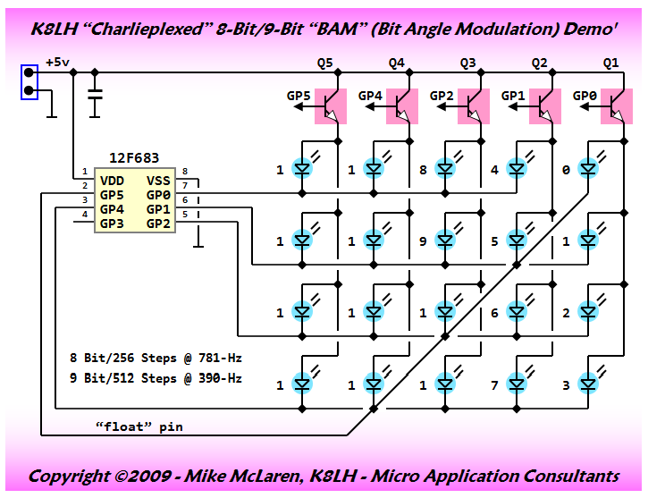

    I've got a 12f683 and want to run 16 LEDs off it. I want one LED to be on for about 2 seconds then move on to the next. What is the easiest and cheapest way to hook them up?
    I'd swear I saw an article that the maximum number of LEDs one could hook to a PIC was defined by 2 raised to the number of pins available. That would mean a 12f683 is capable of controlling 64 LEDs (2 to the 6th).
    Is that true?

    Adding column drivers to a Charlieplexed matrix allows lighting multiple LEDs in each column to increase duty cycle and brightness. If you're only going to light one LED at a time you can eliminate the column driver transistors.
    With Charlieplexing you get N(N-1) outputs (N = number of pins)...

    Remember that most 12Fs usually have an input only pin (mclr/gp3) but yes with charlieplexing and driving your leds at a higher current / lower pulse width should do the trick.
    Anyway if you want more and more outputs, just use a 74HC595 connected to the 12F combined with shiftout command for an unlimited number of them if your timing allows them to refresh
