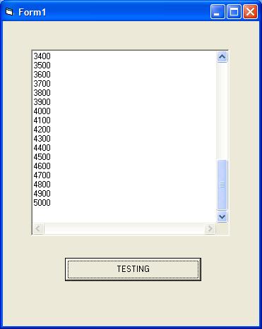

    Like I said before, use the first line of code only once. Use the other two lines of code for the rest of the incomming data.
    Using the first line again and again will "reset" the text in your textbox. If you need help post all your code. This code works fine because I tested it.
