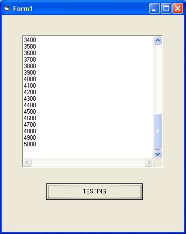

    Ok, I will make it even simpler. This is the code I'm using to test the multiline feature
    Option Explicit
    Private Sub Command1_Click()
    Dim MyNumber As Long
    Dim I As Long
    MyNumber = 0
    For I = 0 To 50
        Text1.SelStart = Len(Text1)             'Finds the starting point to append text
        Text1.SelText = MyNumber & vbCrLf       'Appends text
        MyNumber = MyNumber + 100
    Next I
    End Sub
    And, this is the result
    Just try these two lines and they should work
    Make sure you have the next settings correct
    For Me Simple is really good!! THIS WORKS !! just changed the mynumber to mystr and bingo scrolls, Ok I just ( learnt somethin )
    Thank You !!
    you spent a lot of time helping! I appreciate it! there was someone else who could use this but forgot who ??
    Thank You
