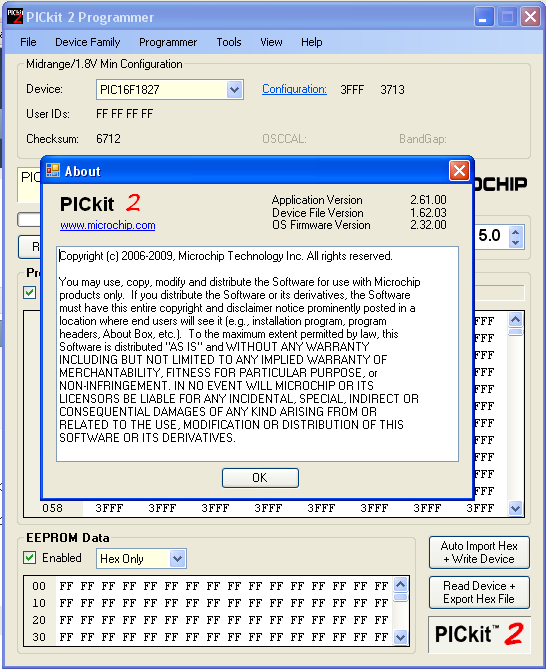

    Your Pickit2 just needs to be updated, and or a new device file. Here is the link: http://www.microchip.com/stellent/id...cName=en023805
    Here's my version:
    Here's my version:
    Attachment 4886
    That's great news. Thanks Scalerobotics!
    I had the latest version of the app, but my device file was old.
