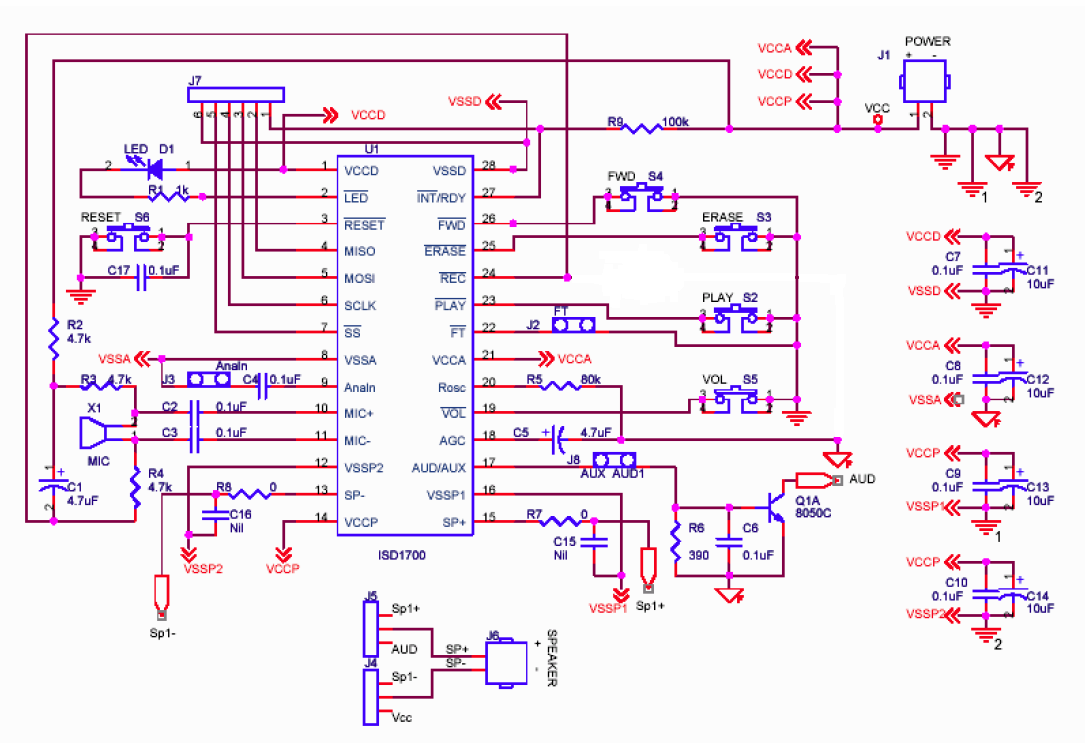

    Quote Originally Posted by MAFONI View Post
    One question, for playback only ever get to use a device programmed PIC? I can not do it in very simple way as were the players in the ISD 2500 series (schematic attached)?
    Thanks.
    It looks like the ISD1700 series requires more external components than the ISD 2500 series.
    Attachment 4894
    Could you tell me what these components, only the portion of the playback.
