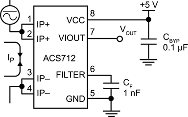

    A lot of people like the Allegro hall effect current sensing devices.
    Key features:
    • Low insertion loss; power dissipation much less than shunt solution
    • Able to monitor both AC and DC currents
    • Smaller form factor than shunt and current transformer solutions
    • 5 V, single supply operation
    • Voltage isolation rating certified by TUV America
    • RoHS compliant
    The devices for 5 up through 30 amp are bi-directional, and are on a 8 pin soic.
Size:  178.7 KBName:  flipchip_712typ.jpg
    http://www.allegromicro.com/en/Produ...rentsensor.asp
