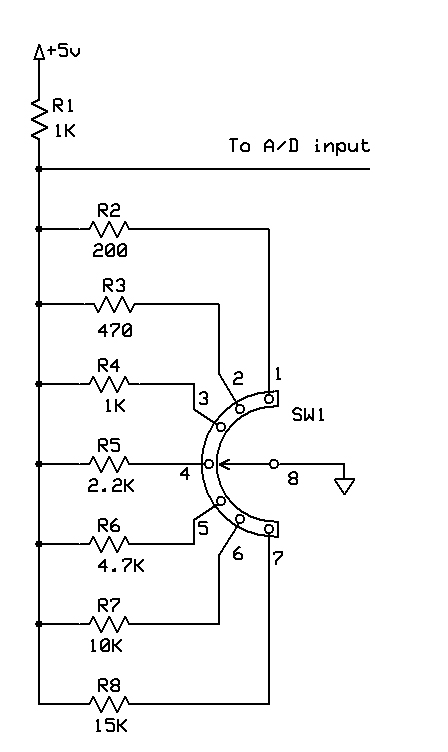

    You can configure your own "switching" pot with a 7 position switch and resistors then use only 1 A/D port.
    Name:  7 Pos SW.jpg
    The values selected were not calculated for anything special just picked something that would probably give a decent spread for a 10bit A/D setting. Then using the SELECT CASE, set the values to the level "between" each setting.
    Suppose position 1 value is 170 and position 2 is 327 then make your 1st CASE setting to 248, middle of the two values, and continue from there for the whole range.

    I just made this a couple of months ago and works as needed!

    thats agood idea, I used a similar switch arrangment but I will drop my if then statement and use Select case, I dod not know it was in picbasic, I used it in C++ a long time ago.
    thanks
