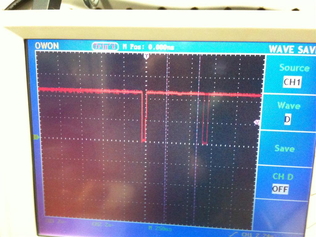

    I put power to my node and it kicks out a "can" message from the tranceiver on the can H and can L BUT the PC program does not show that it has received a valid can message. The weird thing is.... The RXCAN light of the dev board is solid (on) and I can change the state of the TXCAN light by changing my input switch data on the pic portD. The TXCAN light will go from solid to not-on to partially light with dirrerent switch data from portD. When I scope this TXCAN pin I see a one blip message (single shot) at a fixed rate when it is either solid or partially lit. I am wondering is this is an acknowledge message that the node is trying to send out? If it is, why would the interface program not register this transmit? Also strange is that a separate TX light that comes on in loop back mode does not light in response to the TXCAN light near the bus. I.E. There is one TX light and one TXCAN light but they are not lighting at the same time when lighting in response to my “can” message, only in loopback mode.

    I have attached my current code as well as a picture of the setup and a picture of the "single shot" the TXCAN pin is showing.

    Thanks for your suggestion. I believe I have tried without looping to the config part of the code and it didn't seem to help. I beleive my issue may be one of timing. I've looked at the formulas but I get lost so quickly. It's not that I have no math skills, I just havent worked with any of these values before.
    I'm going to hook up the scope and put both waveforms over one another from the working dev kit and then what my unit is outputting. If the rise and fall times do not change state on the same vertical lines, does that mean my timing is off in one system?
