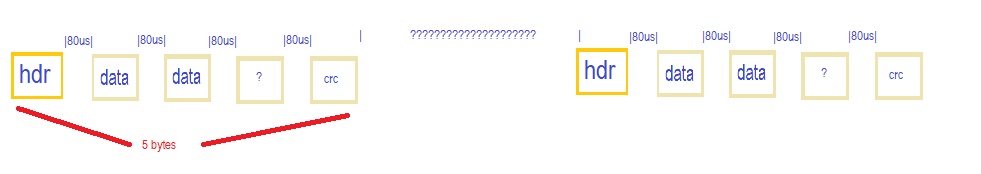

    Default Re: Serin after instant interupt?
    if your data looks like this
    and your chip is fast enough
    a isr routine like this [clear the flag, set inx to zero, set edge index active and off you go]
    when flag set you have a pkt
    might work in pbp
    i would do in asm though
