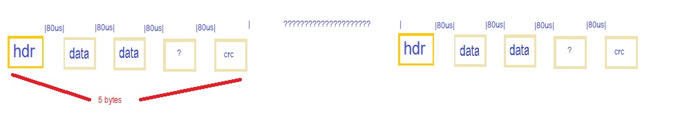

    if your data looks like this

    and your chip is fast enough

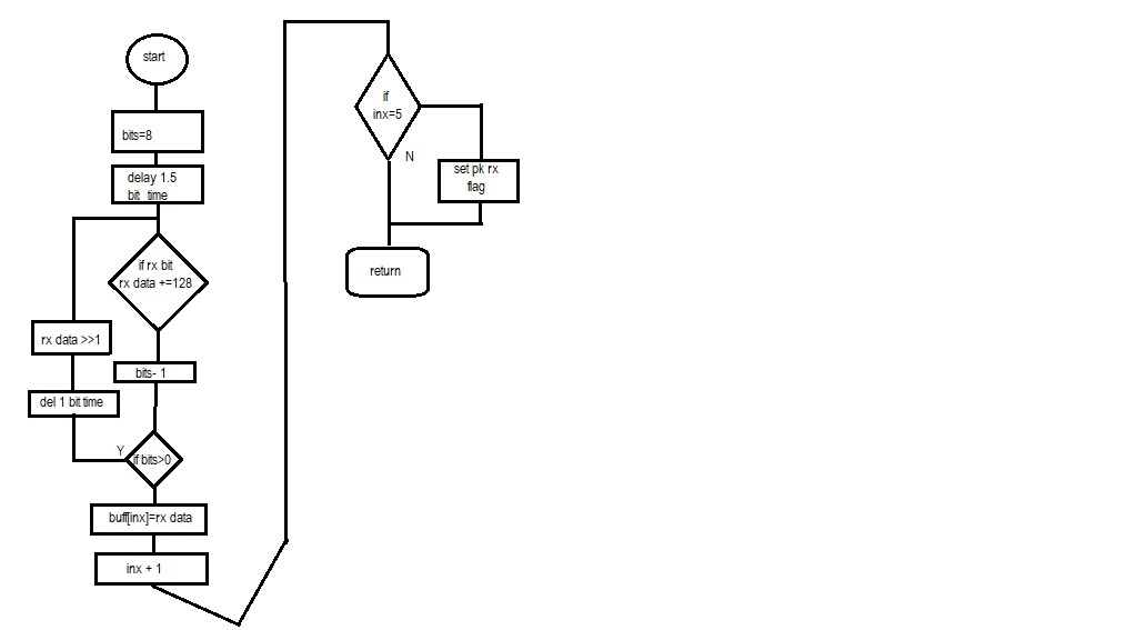

    a isr routine like this [clear the flag, set inx to zero, set edge index active and off you go]
    when flag set you have a pkt

    might work in pbp
    i would do in asm though
