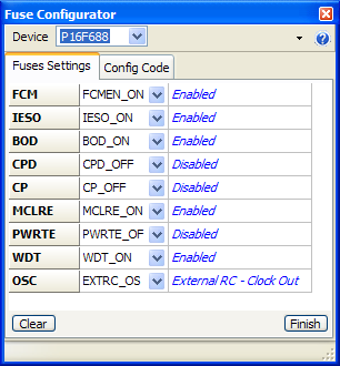

    Maybe fuse configuration would be a good place to start?

    Fuse settings is a good starting point as there is a lot of confussion on this. Every time I change a chip I have to scan the fuse settings which arfe not very obvious sometimes.
    You too? My last big problem was a fuse mistake.
