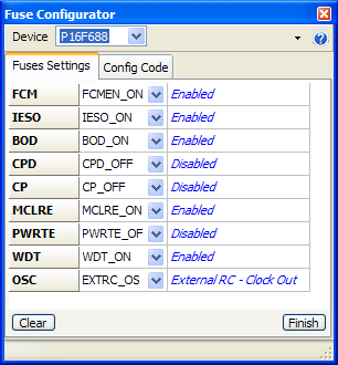

    It looks like Proton has a simple config "tool" here:
    http://wiki.picbasic.org/index.php?n...seConfigurator

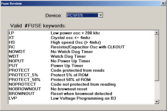

    CCS just shows you the configs, like this:

    It would be nice to expand on it, and make it easier. I think everyone has gotten stuck with configs. I know I sure have.
    With a quick look around the net, I can't find any manufacturer or software maker that has made this very easy for any chip. You would think Microchip would be interested in this, as it would really give them an edge. Perhaps you can sell it to them when you are done!

    CCS seems more human friendly with the plain english explanation. What the heck is that FCMEM_ON anyway?
    You see what I mean?
