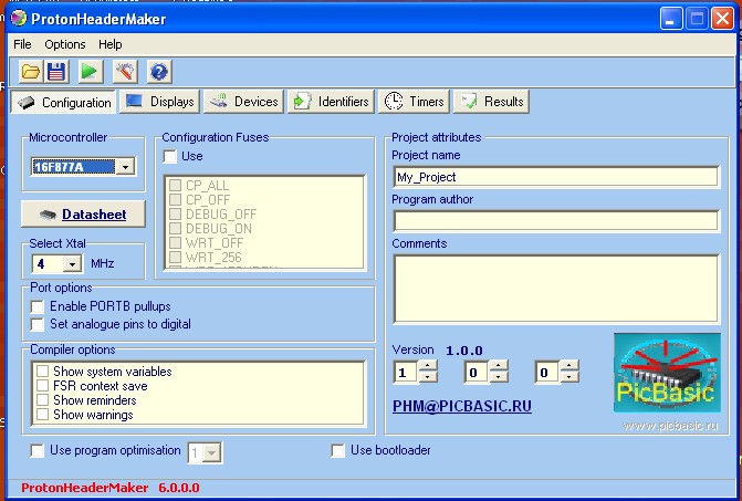

    448
    1. User selects uP
    2. select initial pin status
    3. osc select
    The Proton guys had developed something that did all the above and more. Unfortunately, I cant seem to find the installable anymore on the net.
    And it could do only 16Fxxx.
    The developed header was of course for the Proton, but could easily be adapted for PBP.
Size:  90.4 KBRegards,
    Anand.

    The Proton Header Maker looks close to what I think we are after. Thanks for the screen shot, looks like a nice layout to shoot for.
    -Bert

  40. #80
    Quote Originally Posted by prstein View Post
    Hello Dave,
    I certainly have no objections to sharing the code for this but I haven't a clue about how to explicitly "open source" a project. I'm open to suggestions.
    I'm writing the application in Delphi v4, mostly because I've been writing in various flavors of C/C++ for the past several months and I wanted (needed!) a change...8^)
    Best Regards,
    Paul
    Not sure how the big open projects work...
    I guess to do it right a license needs to be decided on, GNU?
    Other than that jut make the code available someplace for folks to play with. If someone adds a function/fix then they let you know. You then work their code into a version if possible then release the updated version.
    If you do not want to incorporate code from others just make yours available someplace.
    If we can find others using Delphi or Python that want to help with this we could give out parts that need worked on. The "J" chip problem comes to mind.
