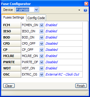

    I think a database approach is great! To be clear, I won't be any help in its development besides being a tester. I have plenty of experience with lotus notes, but thats about it. I will learn if anyone wants to point me in the direction of the starting point for python. But my startup time may well exceed the time it takes for you pro's to be done.
    So I will take a stab at how I see the "work flow" of writing a new PBP program:
    click the wizard icon to start the wizard
    upon it opening, choose an existing device,create new device, or check for updated db
    existing device:
    page 1 has config stuff like clk, wdt, etc
    next page could be hardware stuff like mccp,a/d,esuart,etc
    next page port assignment and I/O choices. also IOC and WPU on this page
    next pages, everything else I can't think of right now.
    finally after a zillion clicks, hit "print" or "Done" button and a text file is created to load into mcs
    check for updates:
    not much to say here, wizard will check for updated database
    create new device:
    form will follow the same format as using an existing device, except all options will be available. (does this make sense?)
    when done, option to upload to the master database
    A note about new device addition to the database. I feel like a new device should have some sort of flag with it indicating it is new and possibly not complete. This flag should ride with it until such time as it is blessed by some (ideas here?) verification method. This is just to try and prevent any badly built entries from corrupting the database.
    The method could be 5 unique users "appove" it. This would get reported back to the master copy of the database.
    My vote is to be able to have a local copy of the database so we are not dependant on web access to use the wizard.
    -Bert

    It looks like Proton has a simple config "tool" here:
    http://wiki.picbasic.org/index.php?n...seConfigurator

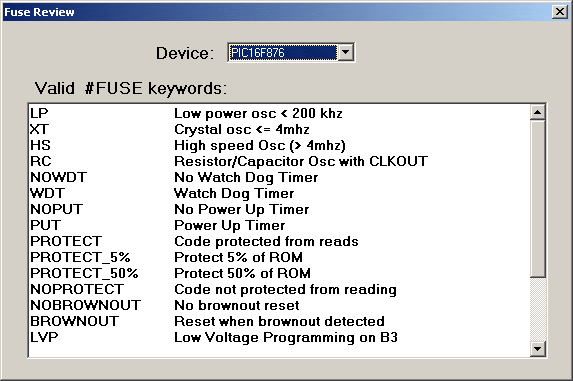

    CCS just shows you the configs, like this:
    It would be nice to expand on it, and make it easier. I think everyone has gotten stuck with configs. I know I sure have.

    CCS seems more human friendly with the plain english explanation. What the heck is that FCMEM_ON anyway?
    You see what I mean?

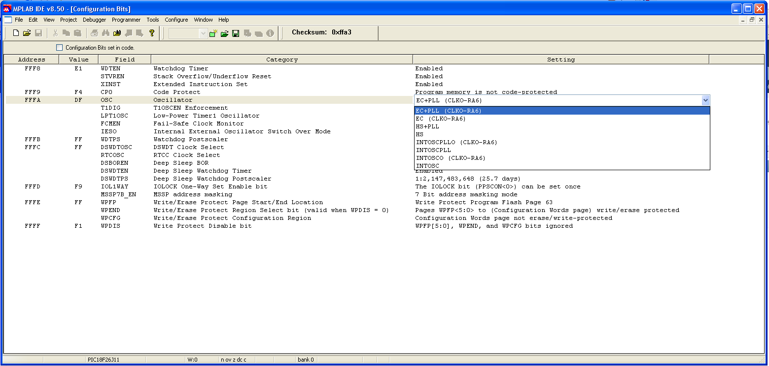

    And what about the MPLAB config screen, once " config bits set in code " being unchecked ???
    noooooo .... not on the head !!!
    Ok, the VDI doesn't exist any more ...
    Ok Alain, I think I am up to speed. Here is the MPLAB window with nifty drop down boxes:
    I had to look up what VDI was. But I like it! Looks like even Microsoft could not keep up with their own chips. When did this VDI get exxed?
    Yes Ioannis, I hear you as well. Like Dave says, a database could be made with all the descriptions. Hopefully a new chips .inc file could be parsed, and the corresponding English text description would be pulled. It would be neat to try initially with two or three families of chips, to see what it takes.

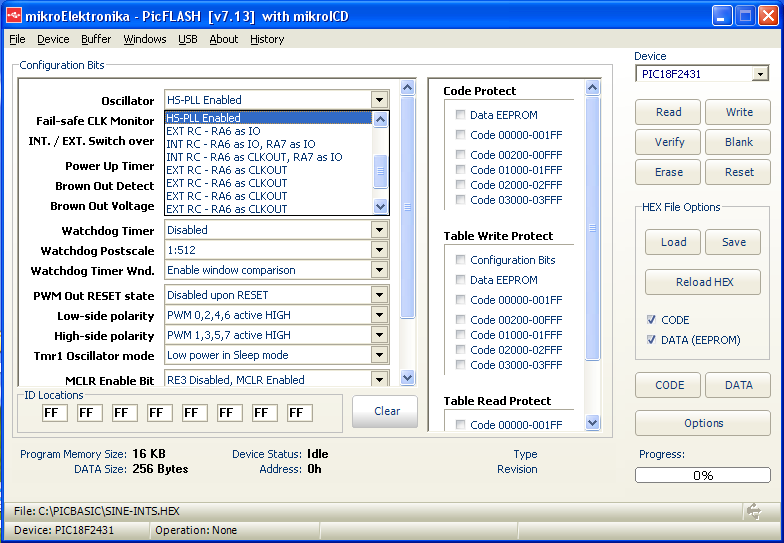

    May I tell you you could have an eye on the MikroE Edit Project Window ...
    on the left side ... the config options
    in the window ... the HEX config values for the different config xx registers ...
    the .cfg file do not show " Config xx " so, it's a bit trickier ...
    BTW ... it's DELPHI written ...
    Yes, I guess I had that under my nose, but failed to notice it. That is about the best I have seen.
    http://www.scalerobotics.com
    Looks like I need to try that.
    Does it produce stuff that can be used in PBP code?
    No, it is the programmer interface, and edits the config bits after compiling your hex file, just prior to programming.

    not the programmer interface, Walter ...
