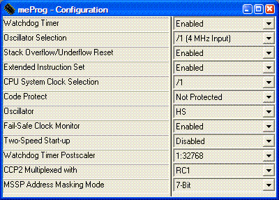

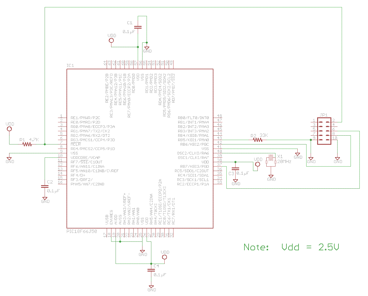

    I'm using an MELabs Pic Proto80 board with a 2.5V regulator. I'm programming through the PP80's ISCP using an MEL U2 programmer. It appears to be taking the code but nothing whatsoever happens on any of the pins.
    My code is below, and I've attached the schematic and a screenshot of the programmer configuration. I'm at a total loss and I would truly appreciate any helpful guidance in this matter.
