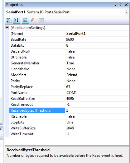

    Hi Henrik,
    Quick question:
    The serial port object has a RecevieThreshold property
    In VB6 it does but does it in VB2008?
    3,604
    Hi,Mine does....but it's called ReceivedBytesThershold, by default it's set to 1.
    I told you my syntax might be off ;-)
    Last edited by HenrikOlsson; - 10th September 2010 at 17:09. Reason: I don't get this new editor....
    Feb 2010
    I live in the UK
    562
    So does mine and I've set it to two
    How did you copy yours and make it an attachment?
