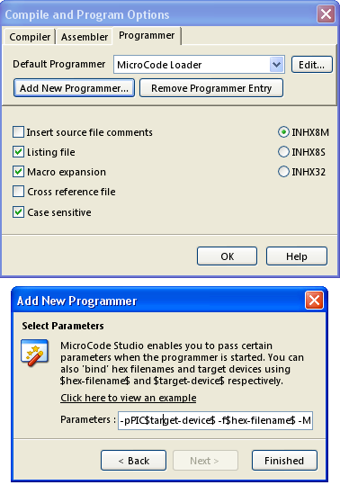

    I have an Easypic5 board that I purchased before deciding to buy PBPro. I would like to use the Easypic5 on board USB programmer with MCS+ if possible. I have found reference here to adding PICkit 2 as an additional programmer (under Wiki as below) but don't understand the final entry "pPIC$target-device$ -f$hex-filename$ -M -R -T -h2"
    Grateful for any advice
    David
    Wiki reference:-
    In Microcode Studio View | Compile and Program Options... | programmer tab,
    click Add New Programmer, select "Create a custom programmer entry" then click "Next".
    Enter any name you wish to call it and click "Next".
    Enter pk2cmd.exe as the "Programmer Filename" and click "Next".
    Click the "Find Manually" button and point it to C:\Program Files\Microchip\PICkit 2 v2 and click "Next".
    Enter this parameter line
    -pPIC$target-device$ -f$hex-filename$ -M -R -T -h2
    Then click Finished.
    Pressing Compile and Program or F10 in MicroCode Studio will now do it all.
    When you add your Pickit2 as a programmer for MCS, you get to a window that lets you add parameters. Here is that window:
    I have not heard of anyone trying to add the USB programmer for the EasyPic board, but let us know how it goes.

    So basically, this parameters line is taking information from MCS, like processor, hexfile etc, and entering this info into the PicKit 2 command line. That is the extent of my guesswork. Er I mean knowledge.
    </string></string></value></value></value></string></string></id></string></memory></rate></rate></newlines></value></value></range></type></file></file></value>-pPIC$target-device$ -f$hex-filename$ -M -R -T -h2
    <value>
    <file><file><type><range path=""><value><value><newlines><rate><rate><memor y region=""><string>
    <id><string #=""><string><value><value><value><string><string> So -P is pic device type, the MCS shared parameter for this is $target-device$
    -f is hex file MCS calls $hex-filename$
    -M means program device
    -R </string></string></value></value></value></string></string></id></string></memory></rate></rate></newlines></value></value></range></type></file></file></value>Release /MCLR after operations Assert /MCLR<value><file><file><type><range path=""><value><value><newlines><rate><rate><memor y region=""><string>
    <id><string #=""><string><value><value><value><string><strin g>-T Release power to device
    -h2 , delay 2 seconds for exit
    Walter
    Hi, Walter
    Very simple with the EasyPic 6 : just use an ICD2 or 3 in the External ICD Plug ...
    like this you can program your chip straight from MPLAB ...
    But is there a way to program it straight from MCS with the compile and program button?
    http://www.scalerobotics.com
    No soucy ...
    Programmer file :
    PicFlash.exe
    Location:
    "C:\Program Files\Mikroelektronika\PICFLASH-mikroICD"
    Parameter line:
    -pPIC$target-device$ -f$hex-filename$ -e -w
    This one perfectly works ...
    Perfect Alain,
    You just saved David and I thousands of unnecessary mouse clicks (in the long run). Is that working for your EasyPic5 David? My EasyPic6 likes it, and so do I.
    Walter
