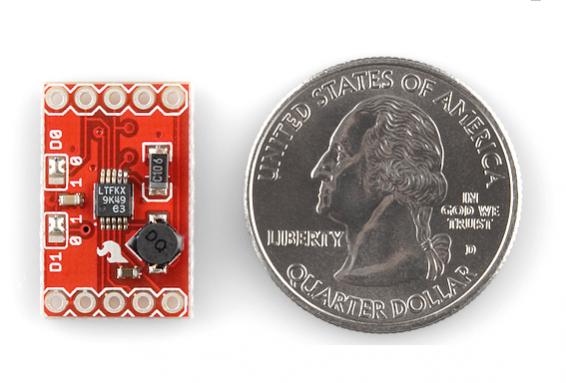

    Default Energy Harvester - LTC3588 Breakout from Sparkfun
    Here is an energy harvesting product that Sparkfun sells, based on the LTC3588. They have some lower cost piezo transducers. But I am sure a lot lower ratings. http://www.sparkfun.com/commerce/pro...oducts_id=9946
    Features:
    • 950nA Input Quiescent Current (Output in Regulation – No Load)
    • 450nA Input Quiescent Current in UVLO\
    • 2.7V to 20V Input Operating Range
    • Integrated Low-Loss Full-Wave Bridge Rectifier Up to 100mA of Output Current
    • Selectable Output Voltages of 1.8V, 2.5V, 3.3V, 3.6V
    • High Efficiency Integrated Hysteretic Buck DC/DC
    • Input Protective Shunt – Up to 25mA Pull-Down at VIN ≥ 20V
    • Wide Input Undervoltage Lockout (UVLO) Range
