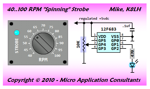

    You could use a circuit as simple as the "Spinning Class Strobe" (below) but you would need to change the potentiometer scale to represent a Period of 1 to 103 seconds.
