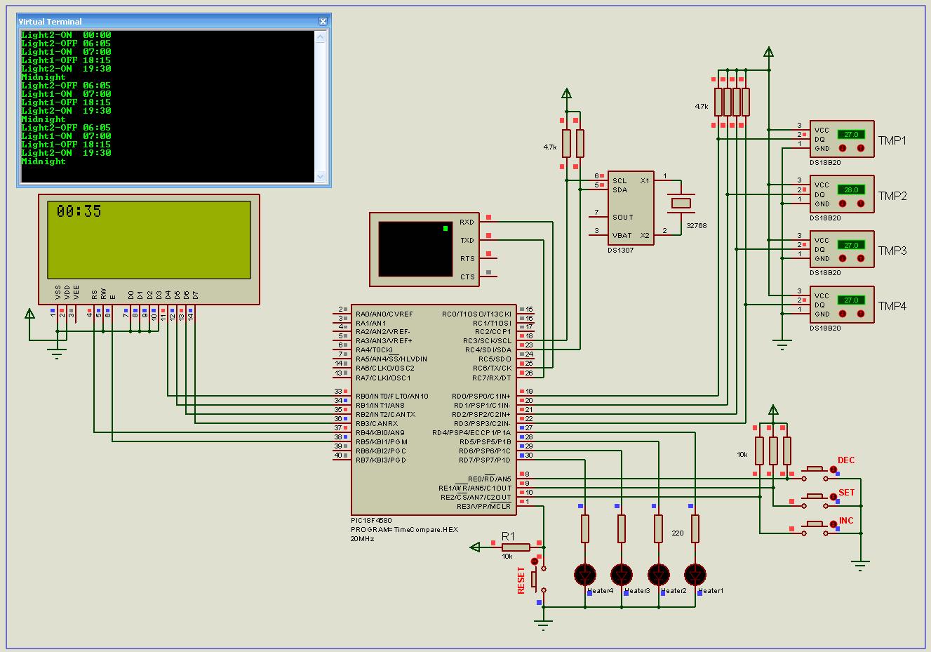

    Darrel,
    Just ripped the LCD out of the unit so I could test this. So far it seems to work apart from one strange thing, the timings are a minute out... If I set the lighting period to come on at 15:00 it comes on at 15:01, and set to off at 15:05 it goes of 15:06, and I don't get anything displayed on the LCD

    Any ideas....??
    Malcolm,
    In the original CheckTimes: routine, the Seconds test had a >=.
    That way it's TRUE when the exact second rolls around.

    I've run it in the simulator and it works perfectly.

    Thanks guys,
    Darrel, I'll give that a whirl later this morning.... and will report back if I have any issues
    Love the look of that simulator.... nice layout
    Thanks for the support
