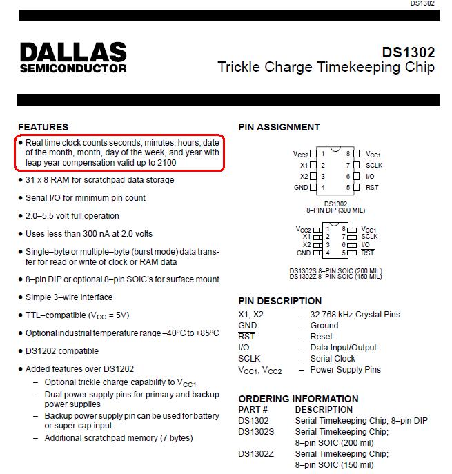

    Just a quick look at the datasheet and it doesn't mention milliseconds .

    Depending on your application, you might be able to use one of the timers, such as the Olympic timer, or the high resolution timer. All without a RTC chip. A few shown here:
    http://www.picbasic.co.uk/forum/content.php?r=77
    Or DT_INTS for 1/100 of a second http://darreltaylor.com/DT_INTS-18/elapsed.html
