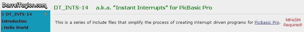

    I am using Pic Basic pro ver.2.50 and I just tried to compile Darryl's DT_INTS-14 (Hello World). The processor selected is 16F628A and I have reinstalled DT's interrupts. In the results window after trying to compile this is shown:
    Error DELETE~1.ASM 726:[224] local directive only for use in macros
    Error DELETE~1.ASM 726:[225] undefined symbole 'iflagreg'
    Error DELETE~1.ASM 726:[226] numeric constant or symbol name expected
    Error DELETE~1.ASM 726:[201] 'expected
    Error DELETE~1.ASM 726:[300]too many errors
    Any suggestions? Thanks
    You must assemble with Mpasm, not PM. Check out the big red warning label that comes with each box.....
