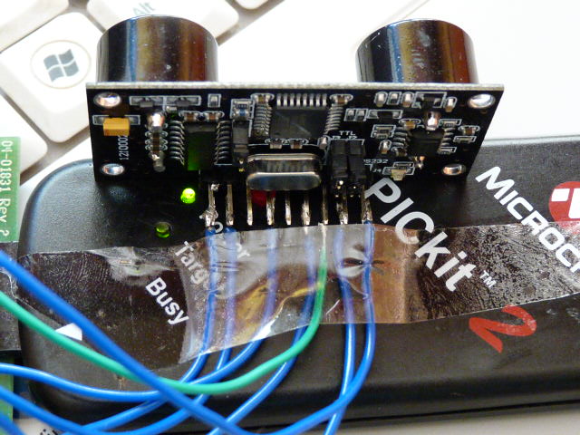

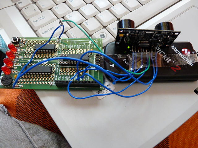

    Hi, it works fine with 2500. Can you please explain how you calculated 2500? Thanks
    500 multiply by 5 meters...
    Quote Originally Posted by Megahertz View Post
    Being Honest ...
    1) read Datasheet Page 3 ...
    4: PWM - PWM Output 025000USEvery 50US represent 1cm
    2) read PbP Manual page 133 ...
    The resolution of
    PULSIN is dependent upon the oscillator frequency. If
    a 4MHz oscillator is used, the pulse width is returned in 10us increments.
    3) The distance is 5 meters = 500 cm
    from 1) and 3) ...
    4) Pulse will be 500cm * 50µs/cm = 25 000 µs
    from 4) and 2) ...
    @4 Mhz Pulsin will return 25 000 / 10 = 2 500 units
    This is the mathematical explanation of zeu thing
