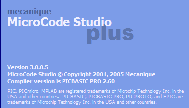

    Hi Martin,
    What version of PBP do you have? MCS is up to version 3.0.0.5, but I think 3.0.0.0 should have had the check box. What does your About show under the Help menu?
    Walter

    Hi Martin,
    Attachment 4439
    Walter
    Version 3.0.0.0.
    I just looked at the 'revision history' at MCS and it showed the last as 3.0.0.0.
    I'll download the copy on the MCS site and reinstall.
