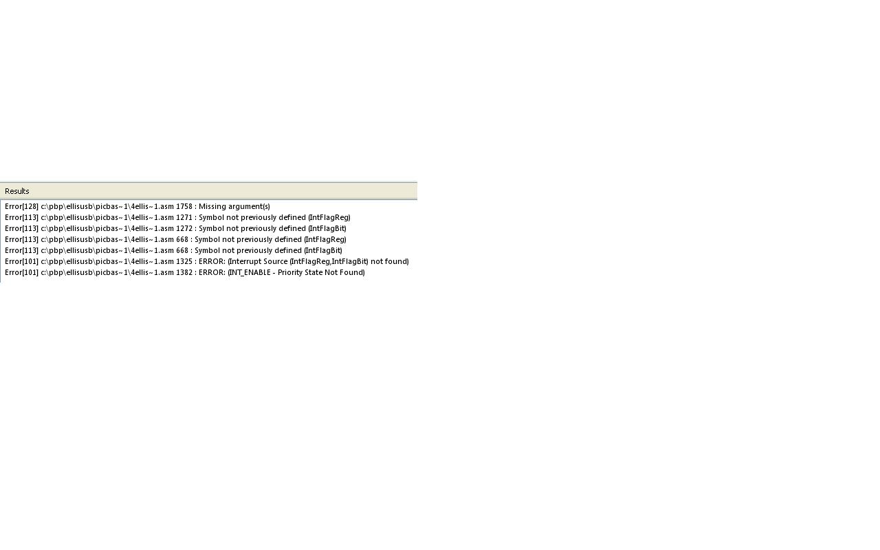

    Darrel, I thought I understood how to do this, but am getting all kinds of assembler errors when I try to compile. Here are the applicable excerpts of code I created to try to follow your suggestion. Can you please tell me where this went wrong??

    Here are the assembler errors I get when I attempt to compile with above code:
