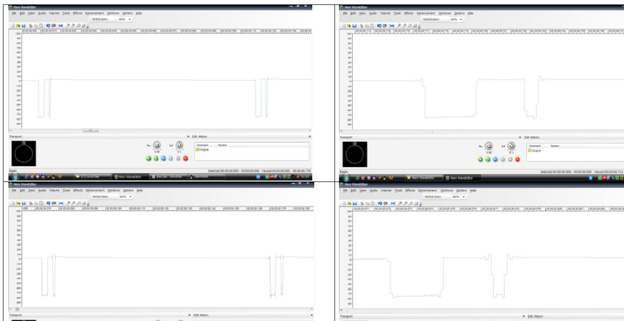

    Dec 2008
    Ploiesti, ROMANIA
    582
    Default I think I made some mistakes...
    ...because with the code posted up, ISIS show me this results for "vol_up" like in picture attached ; it's something wrong ?! Thanks for your attention & cooperation !
    Dec 2008
    Ploiesti, ROMANIA
    582
    Default ...me again...
    ...with some modification ; the results are now OK (in simulation, hope in real-world too !).

    On first row: original Blaupunkt remote, volume up command.
    On second row : my remote, volume up command.
    Using same sensor (original Blaupunkt).
    Original-work; my-NO !!! I'm stuck, dissapointed, sad...

    Could you attach the 2 wav/mp3 files? I'll open them in a sound editor at my end; couldnt quite see the whole pulse train.
    If this forum doesnt permit audio attachments, you could mail them to me at ardhuru_at_gmail.com.
    Also, some remotes send the same frame twice; does your Blaupunkt need that?
