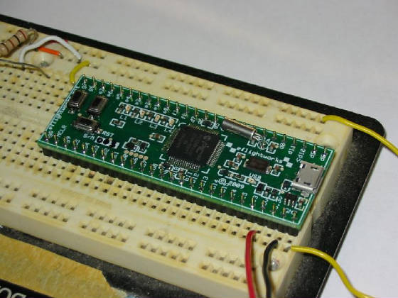

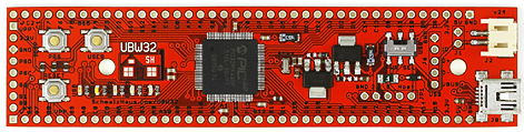

    Here is something that exists, only hard to find, and almost as expensive as the others:
    http://mysite.verizon.net/reswwg6r/id9.html

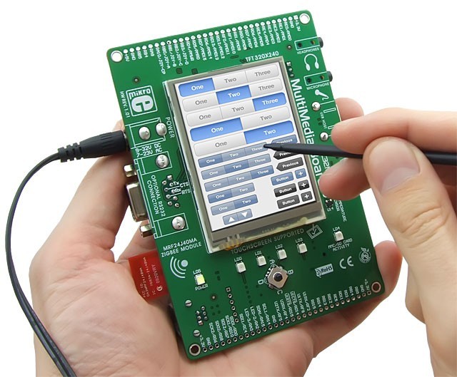

    And I found this at the Mikroe site. Lots of bells and whistles (not claimed to be compatible with StickOS). And the graphic lcd would certainly be very difficult, if not impossible to interface with using StickOS. But interesting....
    http://www.mikroe.com/eng/products/v...timedia-board/

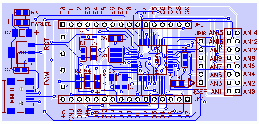

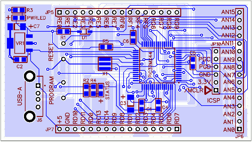

    Here's a couple of screen captures of the board so far. I've attached the DipTrace board file also if anyone wants to have a go at making it better, smaller, etc. It would be nice if someone else verified all connections also.
    It's similar to the SparkFun board, but I dropped the USB host option, rearranged things a lot, and attempted to make it Stamp-Like, but it's tough to route if you keep the headers close enough together to insert in a small breadboard, and I did NOT want to go any smaller than 0805 resistors/caps.
    Board size is 3.2" x 1.8". The smaller capture is 100%. The large is blown-up so you can see everything with connections.
    I can have a BOM ready in a day or two, but will wait for feedback, changes, yada-yada...;o)

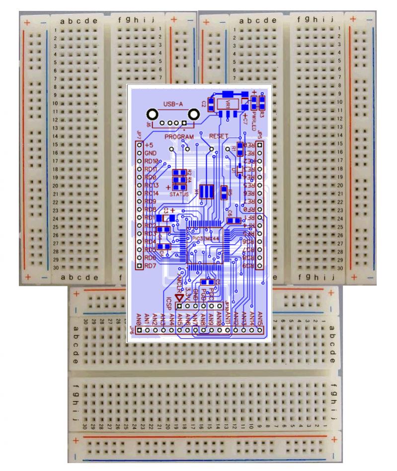

    Bruce,
    What kind of breadboard will they fit into?
    If JP6 is 0.1" spacing, then JP5 and JP7 are 1.5" apart.
    But all my solderless breadboards are 1.1" max.
    The headers would end up in one of the power rails.
  13. #53
    Duh! Nevermind.
    It would go across the power rails between two breadboard strips.
    Sorry, I'm just excited about it.
    Carry On.

    Hi Darrel,
    I suppose it could be done, but the board would be pretty long, and there wouldn't be any room for labels on the connection headers. The 64-pin PIC32 TQFP package is pin-to-pin/side-to-side 12mm wide, so you have little to no room.
    -Bruce

  15. #55
    No problem.
    I'm sure it will work just like this ...
    In fact, it fit so well I figure you must have designed it that way.
    Works for me.

    Looks great Bruce. Yeah, I kind of hoped it would fit on ONE breadboard, but that sure is a lot of I/O! I have two or three breadboards to put it on if I need to.
    One other thing. What kind of USB connector is that? It looks like one of the printer styles, but I could be wrong. Not sure why I think it matters, but it would be cleaner to keep the low profile over the whole thing and do a smt mini usb connector instead. Who knows, someone might want to send this thing up in a model airplane or rocket or something. (Maybe that's just me )
    Thanks a bunch Bruce.
    Walter
    http://www.scalerobotics.com

    2,405
    3 breadboards! Yikes...
    I'm putting female headers on mine for the analog pins.
    I could suck-it-in for a version that would drop right into a standard single breadboard, but I'm just not in the mood to sit & hand-assemble 30+ boards under a microscope for a freebie...
    And - it's really a drag for someone that gets one to replace any parts < 0805 by hand.
    If someone prefers SMD switches, I can change that, but they're normally more expensive. I definitely do not want the SMD USB-A connector. These things tend to rip-off & lift traces with just a little wiggle. I tried really hard to keep it super cheap, but I'm open to feedback if someone wants something changed.
    You should be able to edit/view it with the free version of DipTrace. The raw file is there if anyone wants to have a go at making it better or smaller.
    Walter - the mini USB connectors are a pain, and not everyone has those teeny cables. I used a standard through-hole A type for stability, and it's easier for me to assemble. And - if we used the SMD mini USB connector, it's way too easy to rip-off the board if you lift up on the USB cable. These need to be installed in an enclosure (like say a PICKit2 or 3) where the enclosure itself provides support.

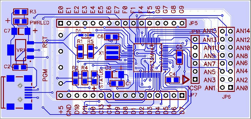

    OK here's one that fits on a breadboard. Headers from side-to-side are 0.9" so you'll have 1 hole left over on the outside edges for wire. Board edges will hang over a tad, but it now fits. Overal size is now 3.1" x 1.475".
    Changed the 1x16 analog header to a 2x8 so that fits, and added Walters Mini USB connector.
    If someone else with Diptrace could verify all connections it would be a big help. It's passed DRC at Freedfm.com, but a second set of eyes might catch something I missed.
    The .ZIP file contains the Diptrace board design.
    -Bruce

    No problemo. I dorked-up the 1st one with the wrong 64-pin TQFP package type anyhow, so I had to change it. The PIC32 we're using is 10x10x1 with 0.5 lead pitch. That just made it even harder to route, but did give up a teeny bit more realestate.
    It needs to fit on a breadboard anyhow since it's not dev-board size, so I spent a few hours changing it around. A 2x8 female header for the analog pins should make it nicer than the 1x16.
    And I went by the datasheet VS the Sparkfun schematic for the VUSB connection (pin #35) to the cap. It's not crystal-clear what they're doing with this pin. It shows ---> with 3.3V just below it. Not sure if they didn't connect this pin or if they ran it to the other 3.3V connections with --->3.3V?
    It could be a LOT smaller with < 0805 components, but it wouldn't be anything I would even consider assembling by hand unless it was just 1 or 2 units. And the price per board would definitely go up, so I'm leaving it at this size.
    I'm going to get in touch with Rich on a clone connector. If I have room, I'll try to squeeze that in too. Then you could connect 2 boards & clone them, but that's a big maybe. If it turns out to be a hot item, I'll make it really small, and probably even ad the wireless, but I'll have someone else assemble them. I just want 1 to mess with to see how it works with the BASIC OS for starters.

    Walter,
    Use this latest version. It's been optimized for a better ground plane, and clearance.

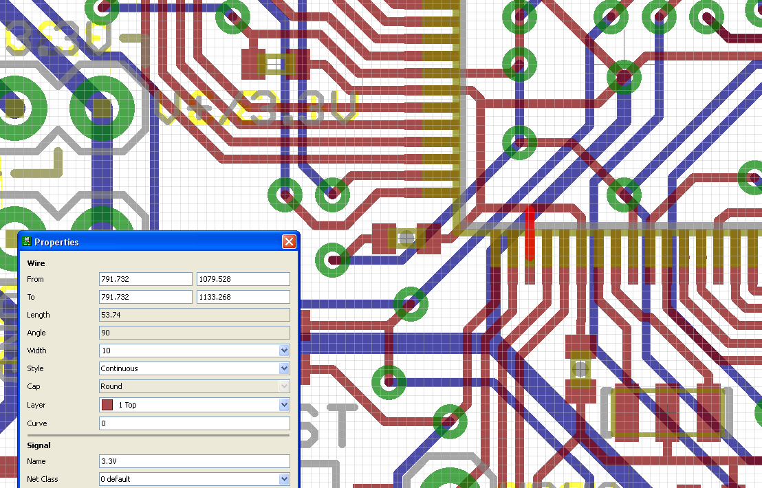

    Default Pin #35
    It wasn't clear at all to me. I located the source files of the CUI32. Here is a view of how they really have it connected... Following the datasheet sounds like a good idea.
    I looked over the obvious on your pcb, and I can't find any mistakes. Pin6 of the programming header doesn't go anywhere, but you probably knew that.
    Walter

    Thanks Walter. I'm guessing they have the internal Vreg disable, so I changed it.
    This is the final version unless someone notices something wrong. It has a lot of spacing changes, copper pour islands removed, and has passed DRC.
    I'm attaching the BOM, Gerber files, and the final CAD file so anyone can get quotes on boards & component prices if they like, or modify the original design as needed.
    I have a bunch of parts on-hand like resistors, caps, /MCLR diode, etc, and some female headers if people want to use them for the analog pins - so it will save everyone a few bucks. See the notes in the BOM for whatever I have a ton of in stock already.
    For a few parts I've included part #s for Mouser & DigiKey, but everyone's welcome to lookup cheaper parts if they can find them.

    I tried to upload Bruce's gerber files (from post# 67) to Sparkfun's BatchPCB site, but I received a message saying " Unfortunately, your design "Bruce__s UBW32" violates our design rules of 8 mil traces with 8 mil trace spacing."
    I am getting a quote on 30 boards from www.pcb-pool.com for the design v2.6 located here: http://www.schmalzhaus.com/UBW32/doc...easeNotes.html
    It looks to be less than $5.00 for each board
    Will let you know more when I get an official quote.
    Walter

  40. #80
    2,405
    Hi Walter,
    I sent you some updated Gerbers, but I don't think you received the email so I'm posting them here. Just in case someone else wants to try making a prototype.
    Sorry I haven't had time to move on this. We sold our big oven before the move, and our desktop unit went ker-flop shortly afterwards, so I'm not doing much fine pitch assembly.
    I increased the spacing, trace widths, etc to 8 mil. Note I haven't made a prototype of this yet, but anyone that wants to is welcome to the files. Guess I better start returning a few chips too. Sorry. If it ain't one thing it's another.
