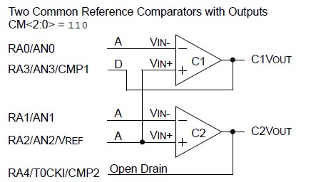

    Ok so I think I have my answer (mostly).
    I realized I must use this operating mode to access the output directly from an I/O pin:
    Therefore I have used CMCON = %110
    Connected RB3 (PWM signal) to RA0
    and I can see the inverted signal on RA3
    Now I still have an issue, the rising edge of RB3 happens at the same time as the falling edge of RA3 but the rising edge of RA3 happens 4uS after the falling edge of RB3.
